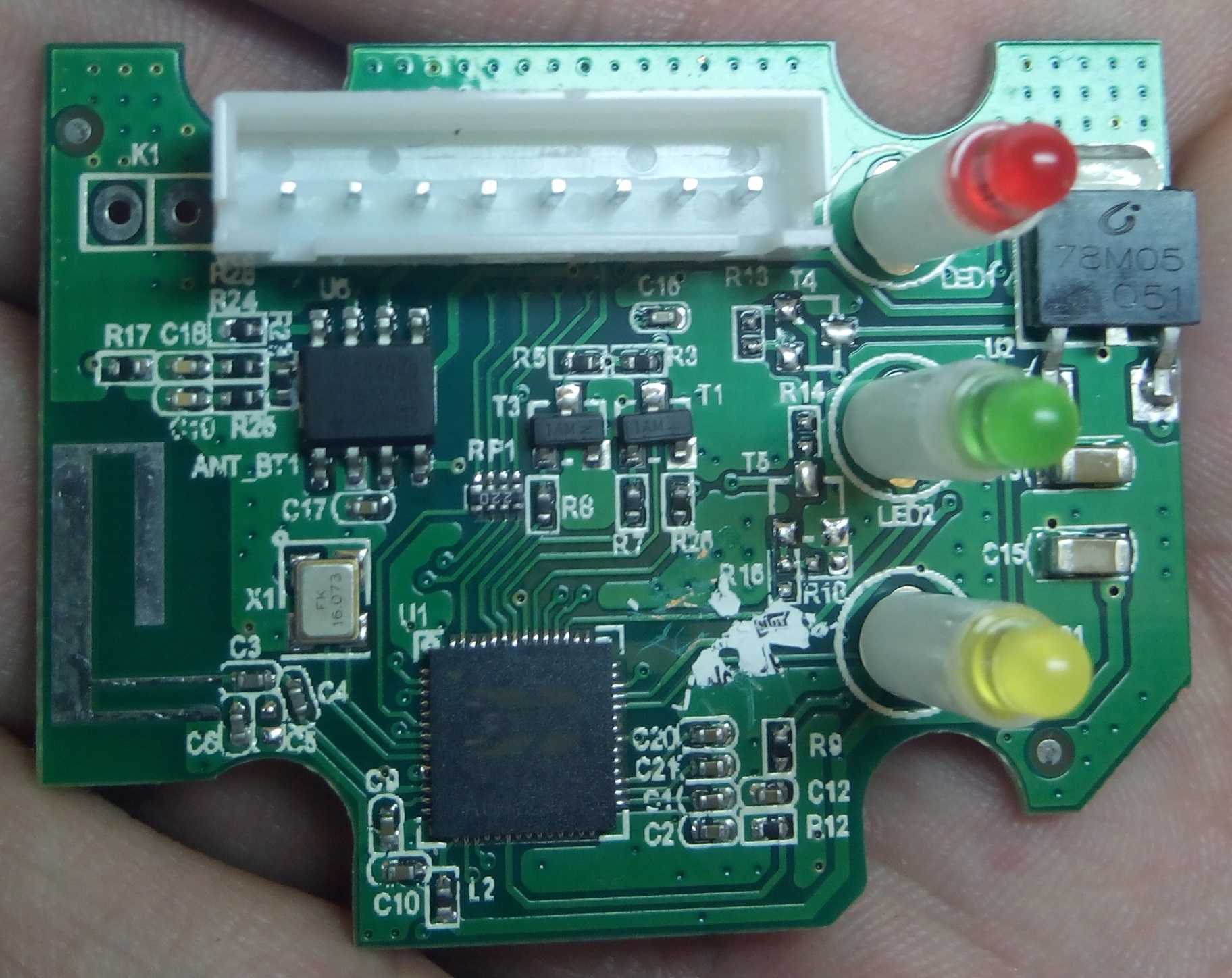

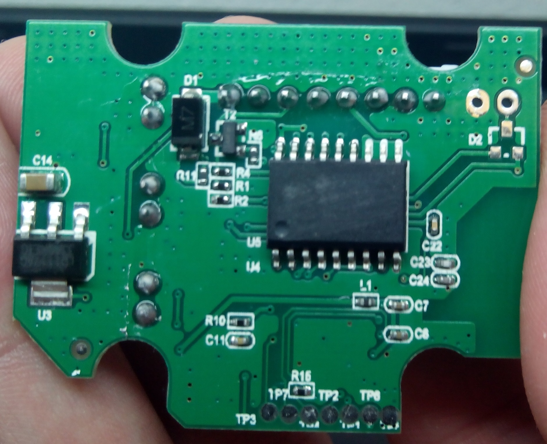

Hi, I'm new of this forum. I recently bought 2 obd scanner, identical to those that bought Zafron. The attached photos are of zafron reply.
Both the scanners work on my kia rio. I bought one of these scanners (it is already the second unfortunately!) for my brother, who has an alfa romeo 159. I have no idea if my scanners work or not on alfa 159, but the PCB and components are 100% identical to those of the photo. I not opened they because there are no screws but is glued, but it is clearly identical looking from the transparent blue plastic. Zafron, even your scanner were glued? Someone else bought a scanner like this, that works? Maybe they realized that the firmware is bugged (if is only a firmware problem) and they solved the problem. Torque is not able to read the version of the ELM327, the "interface version" voice remains empty and both the scanners have the same MAC address, but this is not a big problem.

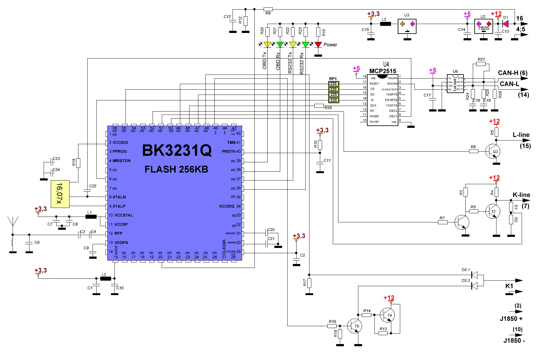

ELM-327(cut):-BK3231Q + MCP2515 + TJA1040
ELM-327(full):-Bluetooth(BC417+29lv800c) + PIC18F2480
The price is identical, not more than $5
http://forum.cxem.net/index.php?showtopic=144556

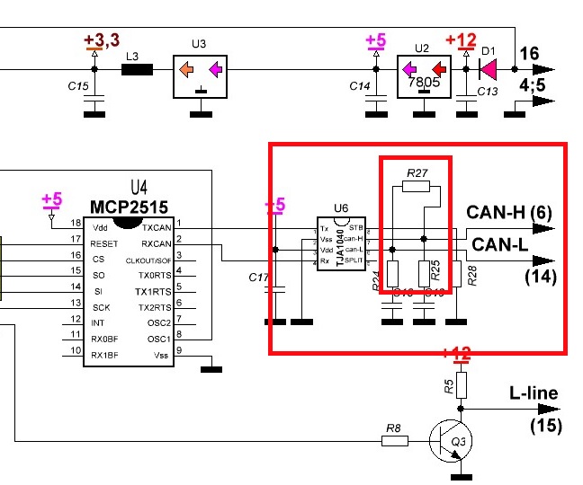

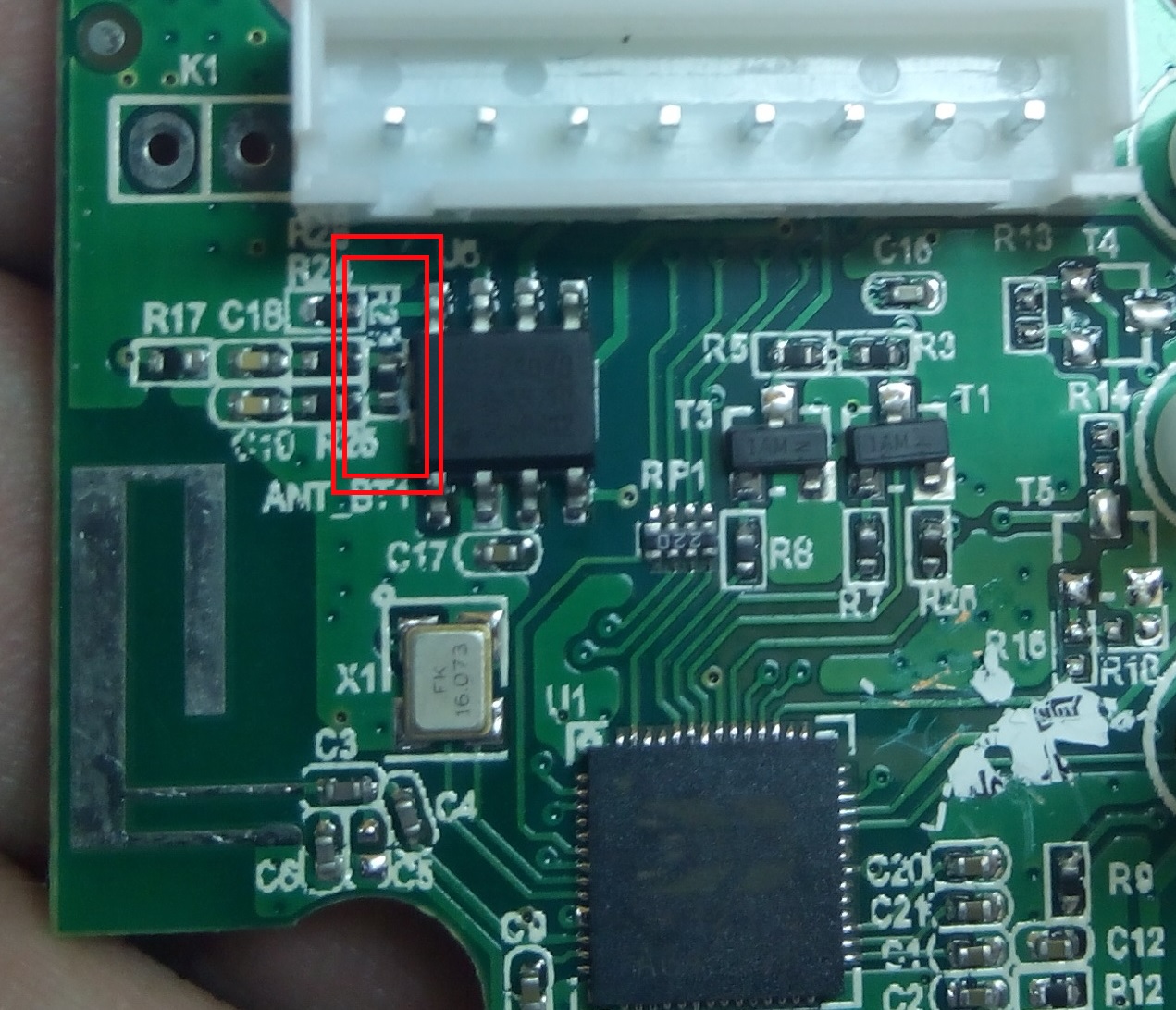

For anyone who comes across this obd, analyzing the diagrams of cxem post, i think i found the resistor on the cam Line. Is the R27. In that diagrams is also visible that the J1850 obd Pins are not connected and i think is this the reason why is not able to connect to the ECU of the fiat car I tried.
I attached the schema. On canH and can L are present, as described in the first post, for each line 1 resistor in series with a capacitor to ground, but is also present the R27 between the 2 can line and i don't know if is correct. Removing it does not solve the problem of connection to the ECU but maybe it could work connecting via multiecuscan for additional units/service/etc.

Unfortunately no. As I wrote the photos that I have used are not mine. I have not disassembled the scanner because the top is glued and i've also requested a refund. I only found that the card is the same as the photo of Zafron, looking through transparent blue plastic, and also identical to the cxem post (http://forum.cxem.net/index.php?showtopic=144556), in which there are more photos of the PCB and the diagram that I reported. We should ask at cxem or zafron if they took pictures of plug and wires.
