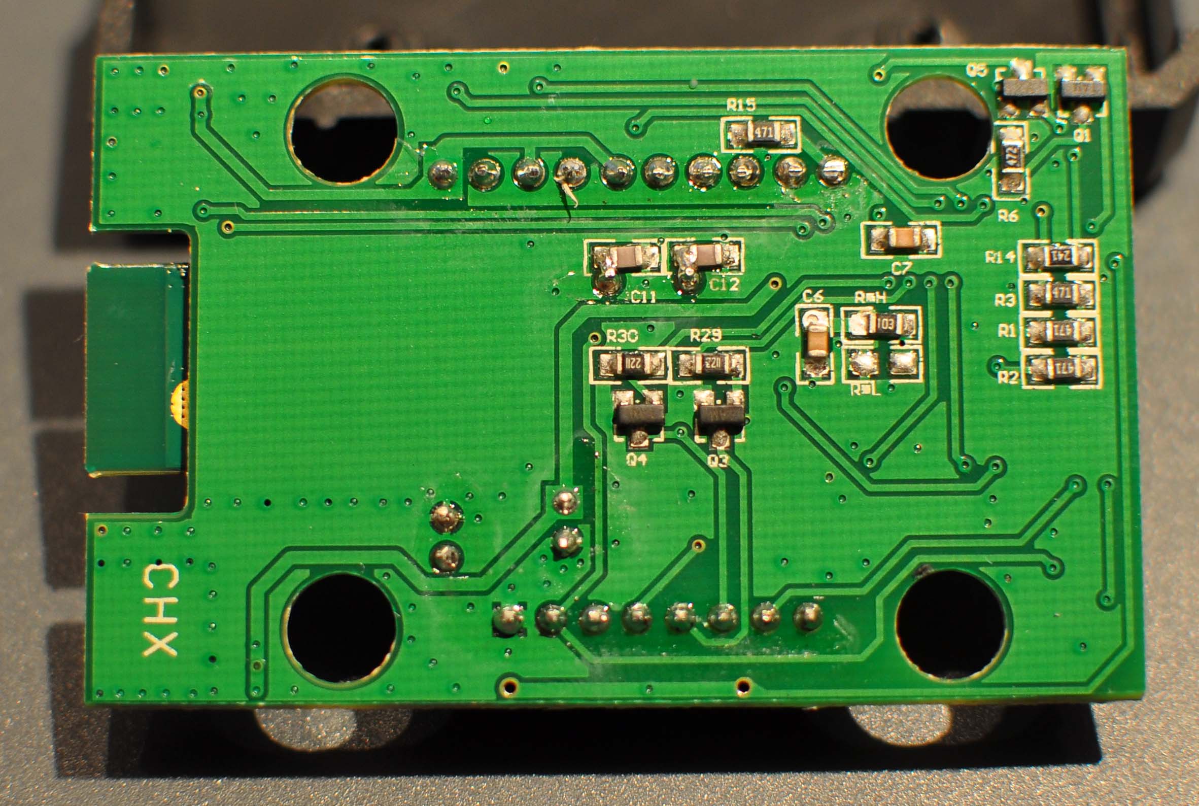

Now to the point: I have the following adapter with an "CHX" board as depicted.
Which resistor needs to be desoldered in order to access the CAN functions? And which functions are accessible over this network?

Are you sure that this interface does not read CAN compliant?
I also have a BT interface have the CHX identifier
The work, however, without error in its original condition.
I suspect rather a hiring mistake
Posted: 28 Oct 2011, 08:22
by hunter555
Hi eddy,
thanks for the fast reply. This morning i checked the wiring and found that one node was loose. Thanks again for this advice.
