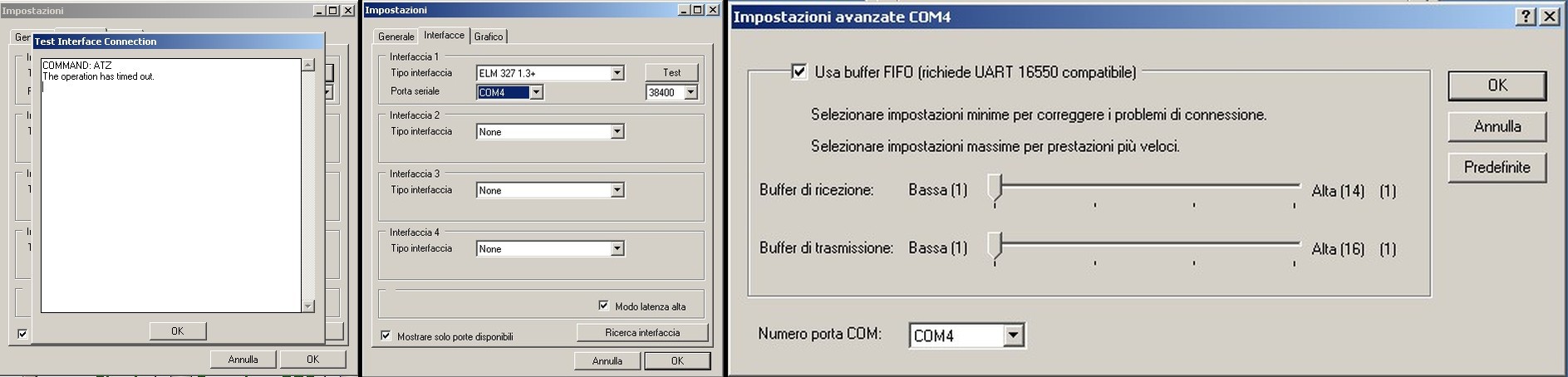

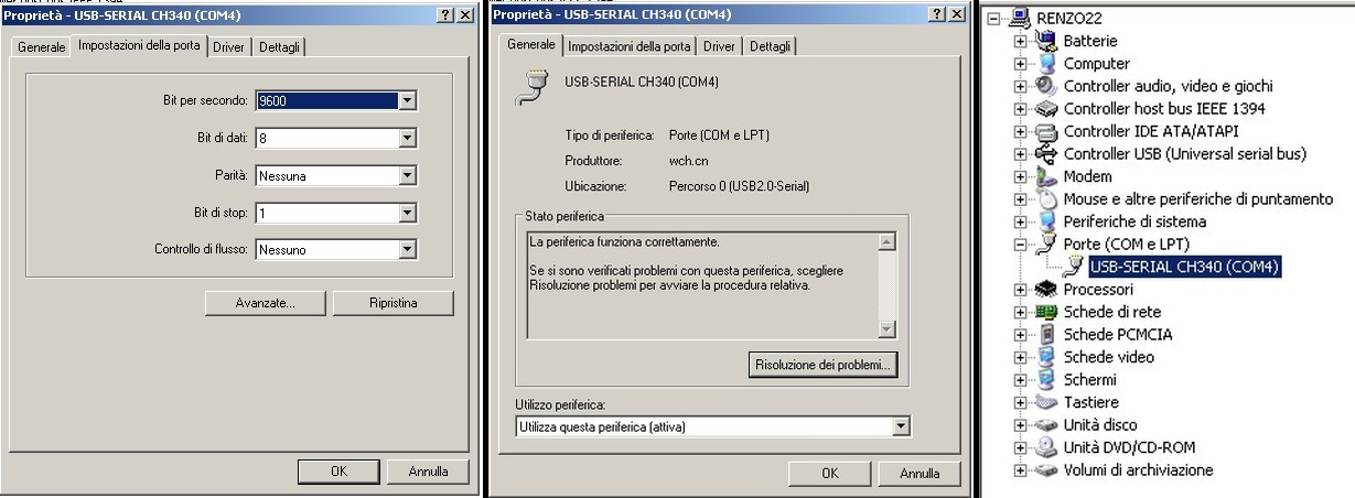

Well, Bigio, this interface is not dead. Very ill, perhaps ...
I do not know if I can help but I'd like to see two screen prints:
1) "COM ports" in the device manager
2) list of existing ports on MES

Waltomatic wrote:Well, Bigio, this interface is not dead. Very ill, perhaps ...
Here what you ask me. I'm nearly sure that ELM 327 USB Cable based on CH340 chip haven't never work with MES.
Someone have this cable (and see in device manager) and can work with MES?
