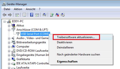

Posted: 01 Nov 2014, 22:44
Hello Luigi
That's me that you can completely new renew any driver in Windows ???
in German
Treiber aktualisieren.jpg (32.58 KiB) Viewed 9873 times

Posted: 02 Nov 2014, 18:41
by Bigio80
Eddy....
"Update driver" can let me install only driver for CH340.
If i try to force install of FTDIBUS.inf or FDTIPORT.inf (drivers for Silicon Labs CP21xx), Windows return me that's this driver not contain information for the ID Hardware that i'm trying to update.
Please stop to suggest the solution to update the driver....this way is impossible with my interface.
Thank anyway.

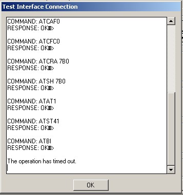

Posted: 02 Nov 2014, 19:02
by Bigio80
Sometimes the interface test function return this result (note strange character in the response result).
Sometimes give more response command but, more than anything else, give only "The operation has timed out"
