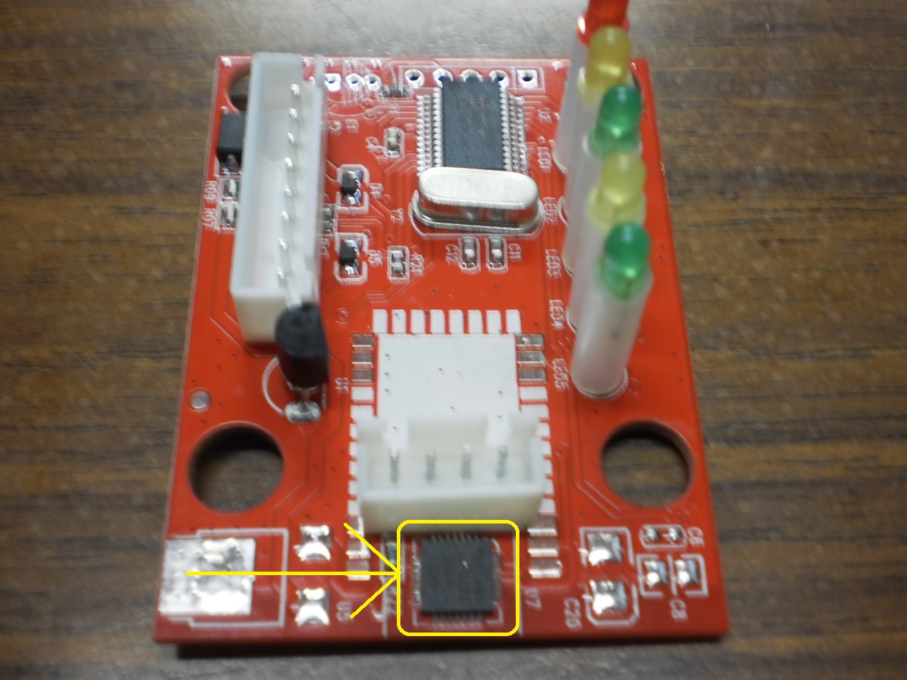

I spend a lot of time trying to know the problem and I'm sure of this:
- on my boaurd is mounted a wrong "USB bus convert chip"
- my board mount WCH "CH340T" but the line on board is made to connect another chip like CP2102
- I can say this because UD+ and UD- pin of USB interface is not connected to pin 6 and 7 of "CH340T" (this pin is not connected)
- the pin 2 and 3 of usb instead is connected to the line 4 and 5 of CP2102 slot (CP2102 is not mounted)
I think that this interface can't work in anyway because they have mounted a chip on a wrong board made for CP2102 chip.
I ask amazon seller to send me another interface...hope this new one is not faulty.
In the pic I have marked the chip than in my board not exist, but exist in the other face the teoric replacing chip that can't work.
Luigi
