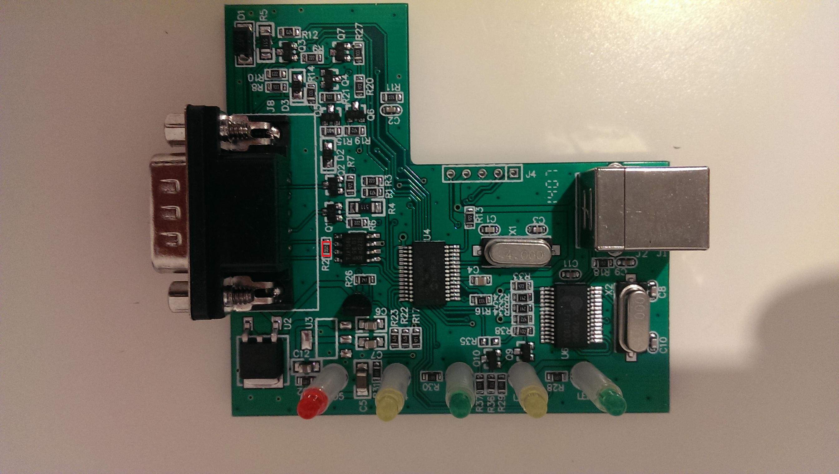

hello,
I have a 327 ELM 1.5a (metallic case) I can scan the engine of my Alfa Romeo 159 2.0 JTDM but impossible to go into the service menu to make a counter reset drain.
Do I need a special cable, yellow?
Thank you for your return.
Posted: 12 Sep 2014, 20:22
No, you have to remove the resistor R2 and then this works
IMAG1055 markiert.jpg (383.3 KiB) Viewed 9800 times
Posted: 16 Sep 2014, 11:46
by touri85
Thank you Alfaeddy !
It's ok for me.
Bye

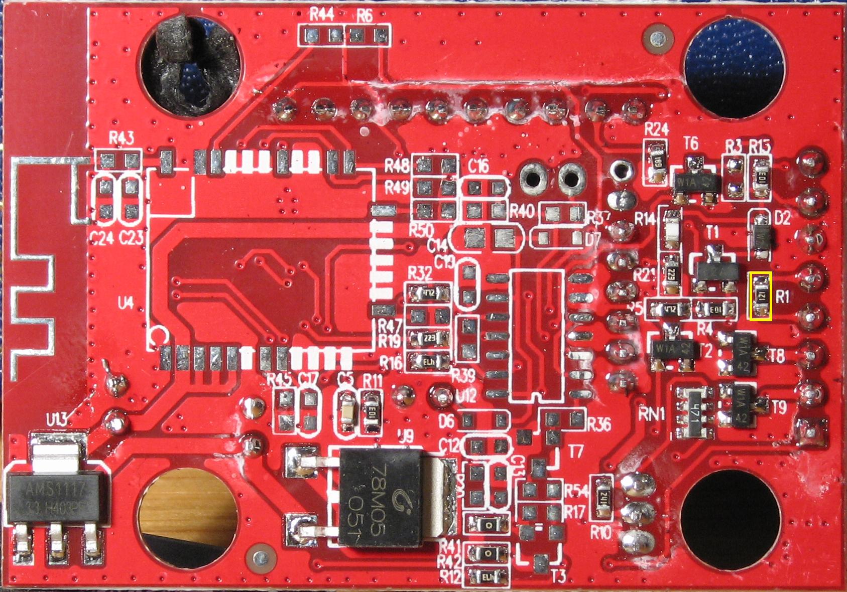

Posted: 28 Sep 2014, 23:15
by hlqq
Hello:
I have the pictured Wifi ELM327. It connect propperly to Engine ECU of my Alfa GT 1.9 JTD 16V but not to the CAN system.
Can someone help me to identifi the resistor that should be unsoldered?
Thanks a lot
hlqq
Posted: 29 Sep 2014, 04:34
hello
Read Remove the resistor R1 and you can also CAN bus
Reverso markiert.jpg (381.41 KiB) Viewed 9733 times
