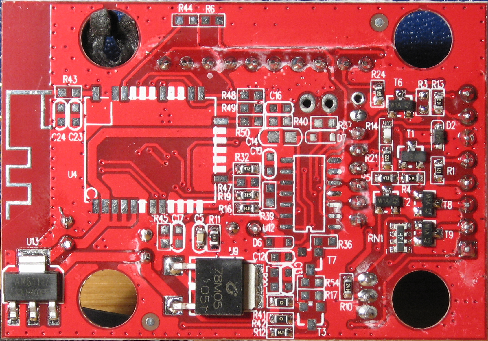

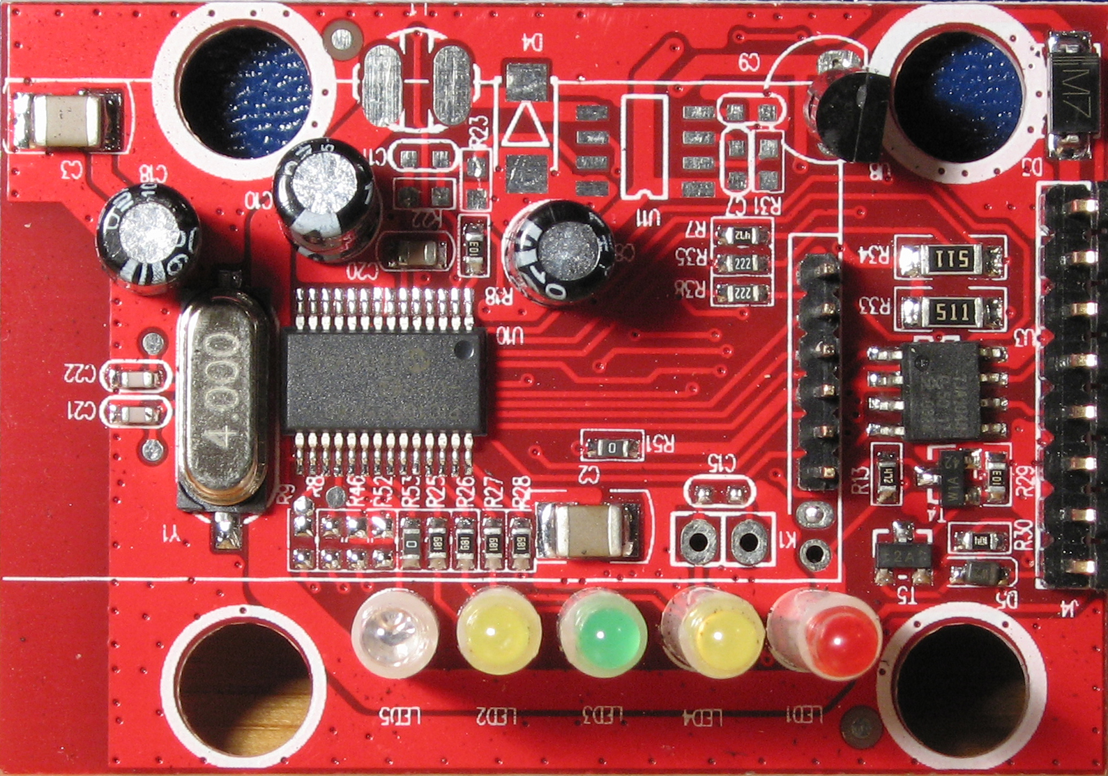

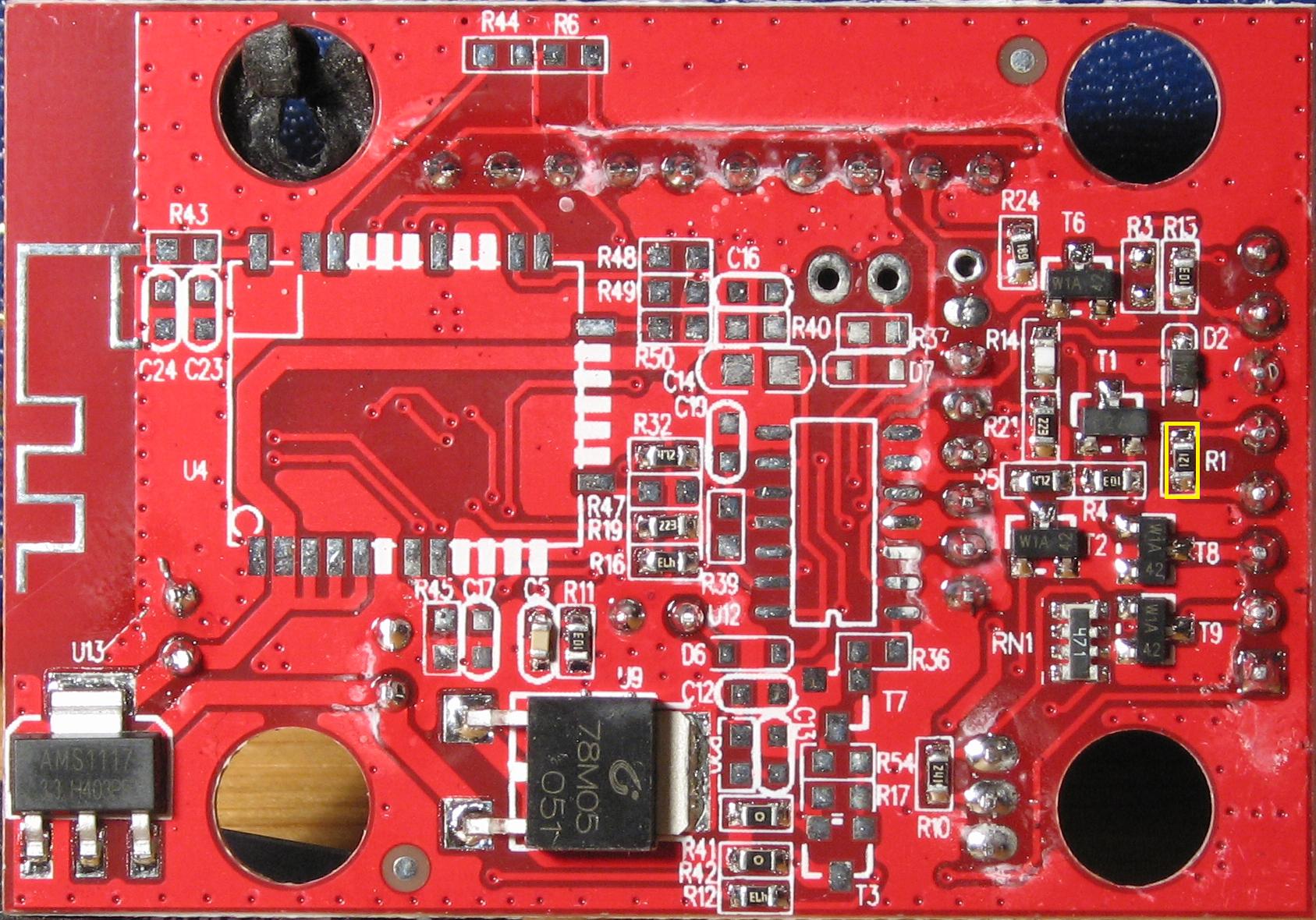

Hello:
I have the pictured Wifi ELM327. It connect propperly to Engine ECU of my Alfa GT 1.9 JTD 16V but not to the CAN system.
Can someone help me to identifi the resistor that should be unsoldered?
Thanks a lot

hello
Read Remove the resistor R1 and you can also CAN bus
