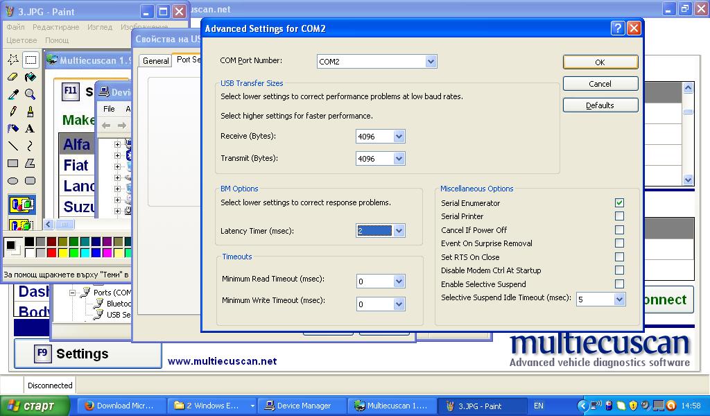

I install this driver you given to me. Not working. I try some different ports as com port 2 and 5 not working too. I try to change the latency from 16 to 1. But not differents. I use multiecuscan can be this the problem?
What is the current settings for the USB serial port? Do I need to change something else than latency from this picture?http://www.ross-tech.com/vag-com/usb/FT ... ptions.png

Hello uglyface
This is all right!
Did you even with MES / Settings / Interfaces / VAG kkl set?
And the same COM port as shown in the Control Panel of the PC?
In this panel there is the right of the interface settings, a test button

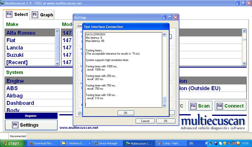

Yes, when i open the MES go to settings and mark Vagcom kkl, then mark the com port as the one that shows me in control panel. For example (the com port on control panel is - 3, on MES i put com port -3) I can`t make picture now, tomorrow i will. But as far as I remember I recieve this messages when i click to "test" The ignition is ON.
Messages:
DATA ERROR!
DATA ERROR!
DATA ERROR!
DATA ERROR!
DATA ERROR!
Many of this DATA ERROR!
And later something with the timing
Tomorrow I will do a photo to see what I do and what happens when i pushed the button TEST

I use windows 7, and yes... no error comes up to control panel, everything looks fine. When i click to USB Serial port to see what happens... its says the driver work properly. Thank you i will try it, but not now because is to late
Tomorrow will tell if it works or not. Do i need to change something on that picture or to leave it that way. This is not my settings is randomly picture from the net.
Do i need to make bridge to 4-5 pins ?

Today i install the USBtoUARTBridgeVCPDrivers i ftdi drivers to my laptop with windows XP. And receive the same messages like before. I attach photos to see it. I receive this messages on windows XP/7 and 8
