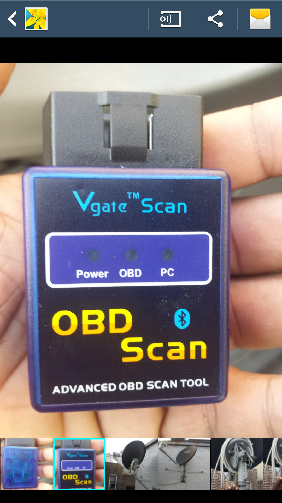

hi,Alfaeddy
this is the elm327 and also let know what software i can use because i used a quit a few and they cannot connect to the ecu thanks
- 2014-08-20 19.15.23.png (1.94 MiB) Viewed 8598 times

@ elpesao
Sorry, but this is about the software "Multiecuscan" for Italian cars
which vehicle you want to read?
You can not use any software and any interface
all possible controls to read.
Please do something more detailed information.

Hello Waltomatic
Resistance = "Resistor" in English. or "Widerstand" in German
You make me confused, once you write the ELM Interface
then again from a KKL interface
Your test picture is of a KKL interface (VAG) and you have the slider shift left, but not at 14 to 1
I think you are using the ScanOBD in the picture, but have in the MES Interface VAG set. !
This is wrong
For the interface in your image, you must cease an ELM327 Bluetooth.
This is wrong
