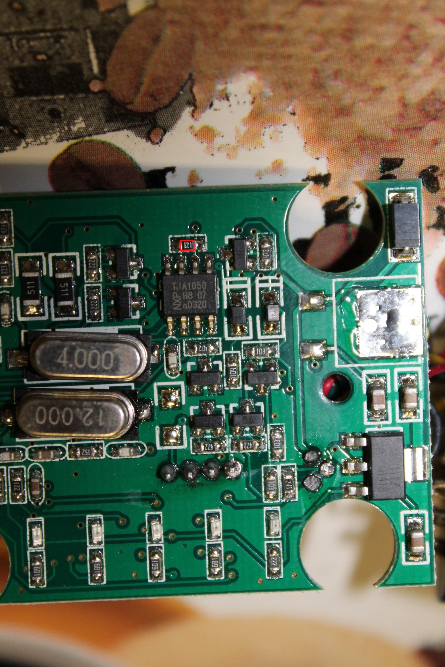

Hello Eddy,
I would say that resistance to delete this?'ve seen in previous posts a card similar to mine, but the code of the IC does not convince me. Could you give me a hand? I thank you in advance
CROCI
Posted: 30 Jun 2014, 20:16
Hello Croci
You must Remove the red marked Resistor
than your ELM can read the CAN Bus Protokolls

Thank you Eddy,
I also figured that was that; My only doubt was the integrated TJA1050 different from other interfaces with the integrated MCP2551
Have a nice day
CROCI

Posted: 07 Jul 2014, 18:51
Hi there
Remove the white base on the connector strip
including a resistor should be found. (R04)
I have the place marked in red
This you should remove so that you can read logs and CAN bus.
But, as already written for your engine ECU and ABS the resistor does not have to be removed.

Thank you for your advice. I did it according to your instructions and everything works.
