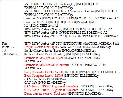

About airbeg, according to supported vehicles list it should be on CAN also (ELM C19). Or i didn't get this list right?
CONTINENTAL Airbag (Ep - PROXI)
- |INFO|DTC|DTC EX|PRM|ACT|
- ELM C19
- OBDKey C19
- A3
CONTINENTAL Airbag 2 (Ep - PROXI)
-|INFO|DTC|DTC EX|PRM|ACT|
- ELM C19
-OBDKey C19
- A3
TRW MY05 Airbag (Ep - PROXI)
- ELM C19
- OBDKey C19
- A3

Your Punto is from 2006 so this list should be true for you.
Punto 1.2 8V.jpg (62.91 KiB) Viewed 8817 times
In 2006, the Punto did not have a C19 CAN bus
In your ELM even the chip (MCP2551) has been copied.
Although this is not protected.
again:
But this chip is only responsible for the CAN Bus Protocol
And the motor control and ABS on the 2006 Punto is not read via CAN bus
but via KWP2000
I guess setting error with you or your interface is damaged .

Probably not damaged but it's not compatible i guess. Using other software i've successfully removed check engine error from one Alfa GT today, but i was not able to connect with MultiEcuScan on the Alfa also as on my Grande Punto.
I guess will have to buy KKL interface to access airbag module, although again for me it's bit confusing Supported Vehicle List. Why Grande Punto from 2006, that was manufactured until 2010 is placed in previous generation Punto that was manufactured from 2003.
In this case probably list should be updated in order to be clear which interfaces are needed for specific car.
