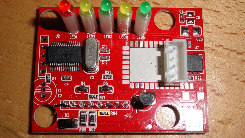

I see a few pages back a fellow posted an image of a red PCB Elm adapter but did not supply good enough piccies. Well, I have the same adapter and they seem to be quite common on ebay these days.
Please PLEASE help!
I can connect to the engine etc, but when I attempt connect to the SERVICE etc option it requested a Yellow Adapter 3 cable (which I then plug in), but then cannot connect.
I assume I have the same resistor/termination problem, however my PCB is laid out differently to the others.
Please find photos of the PCB in question.
Thanks in advance guys.
Posted: 16 May 2014, 08:12
Hello abraxxious
Remove the white plug please Holder with 8 contacts
including I suspect the bridge resistance.
Your pictures must not be so large, only the resolution should be high
Not so blurred
Edit: It should be around this ELM?
then remove the yellow-marked resistor.
1 markiert.jpg (147.58 KiB) Viewed 14836 times
Posted: 19 May 2014, 04:39
by abraXXious
Woohoo! It works!
Thanks guys!
