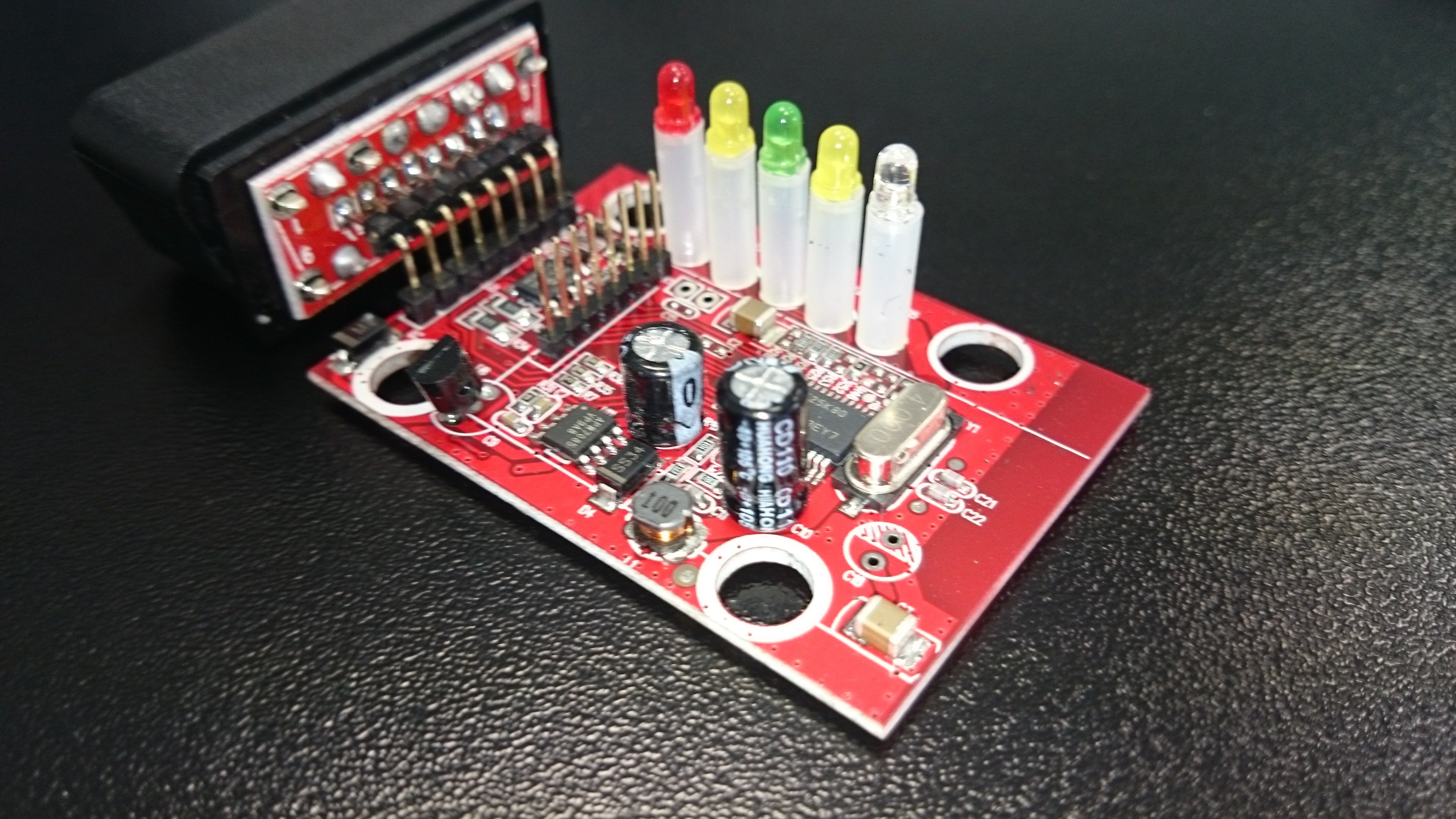

Chinese ELM327 Bluetooth.
which resistor should I remove in order it to work?
Punto MK2 8V
incorrect area :oops:
cmosfxx wrote:
Alfaeddy wrote:
cmosfxx wrote:ELM 327 WiFi
Is this the resistor I have to remove ?
Yes it is the right Resistor
Thanks! Works.
Nice that I could help you

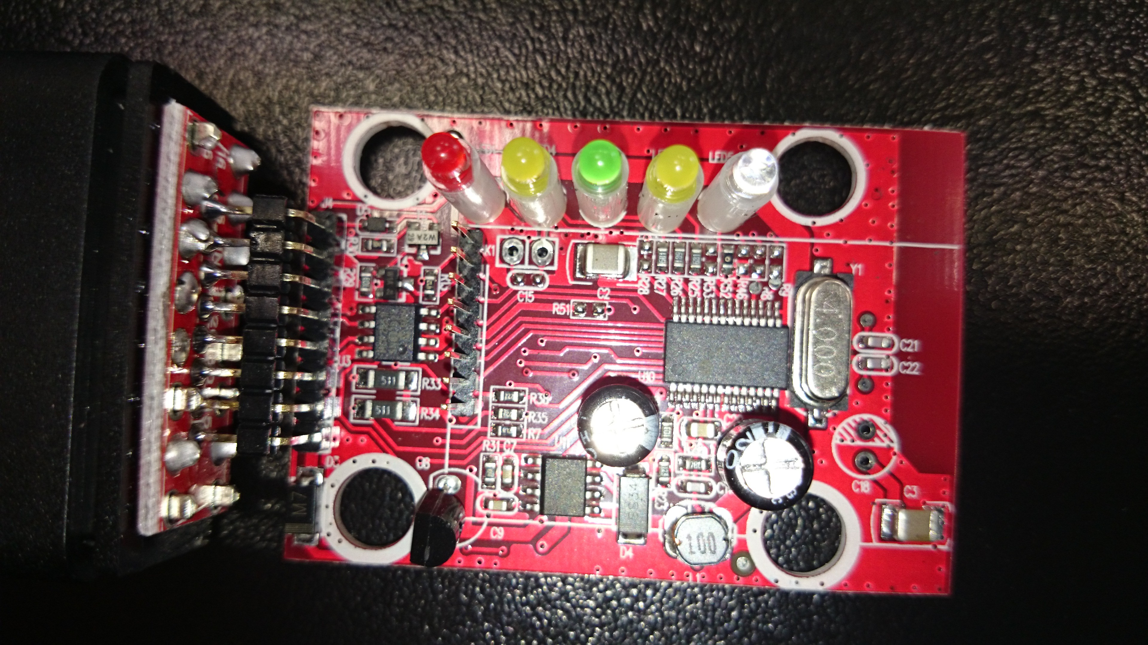

Hi there,
I purchased an ELM327 v1.5 Bluetooth OBD reader which detects when plugged into the car, but won't connect to the ECU. My car is a 1998 Hyundai Excel (australia) & according to hyundai, it's OBD2 compatible.
I tried to post larger images, but was getting an error saying I could only post images upto 800pixels wide...
I tested pin 6 & 14 and found a resistance of 121. I traced it to Resistor(?) 121 & removed it (I thought I had too.. now I'm not too sure :\ ) as seen in the picture above.
Unfortunately the PCB doesn't have any writing to say what is what :\
I connected it to my car again after removing, and still won't connect. I'm pretty sure it uses the 'CAN' protocol.
Any tips would be great :)

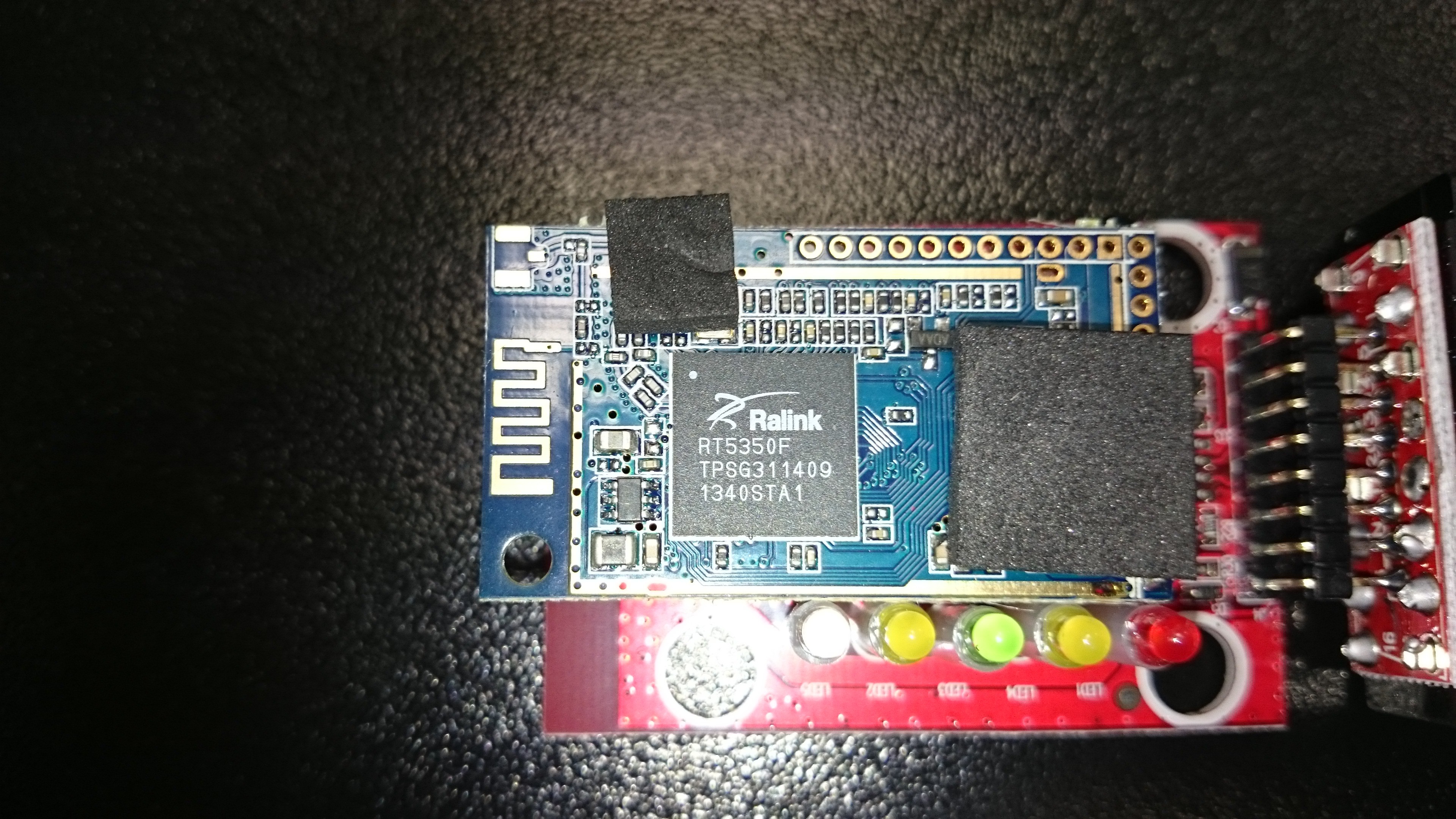

hmm I didnt found here my type of elm . So the simple question is... hot to fix my elm to read all as yours ?
Mine is elm 327 with only wireless connection ( make a wi-fi web between pc and the device )
Hi stefancaromov
What problem you have with the ELM?
Which vehicle would you like to read?
What controls you can not read?
Your pictures are very large but very blurry
I can recognize as a mistake on your ELM.
Especially not since you're describing a mistake.
