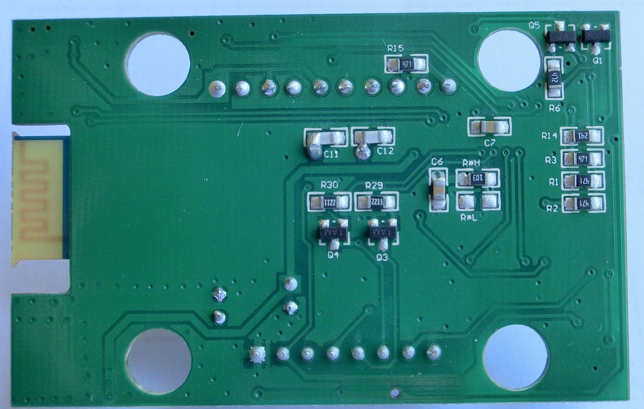

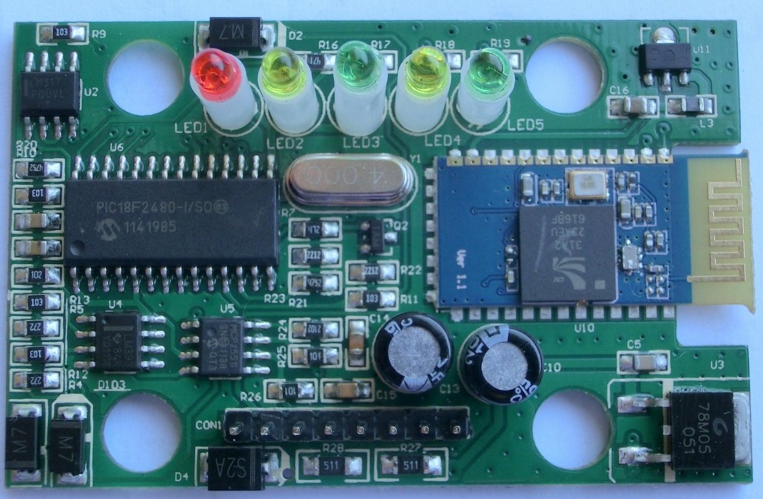

Welcome. I have ELM 327 BT.
The device connects properly with the Fiat Panda 1.1. Read the engine. No connection to the ABS and airbag.
Tested with program Fiat Ecu Scan.
Please help me.
PRZÓD (Kopiowanie).JPG (251.12 KiB) Viewed 9281 times
TYŁ (Kopiowanie).JPG (263.87 KiB) Viewed 9281 times

Posted: 23 Apr 2014, 20:32
Hello r_bobas
What Panda you have exactly?
from the `03?
Then this is understandable
With this interface, you can read as you to a KKL interface requires no airbag.
Possibly with red adapter
And to be able to read the ABS you need the green adapter.
So close the interface and buy yourself the A1 adapter
And switchable for the airbag a KKL interface or with red adapter

Posted: 25 Apr 2014, 09:13
by rosenmvr
Colleagues have 327 Elm ver.1, 5 please help me what should I remove the resistor and if I should put capacitors. I freaked P04 but I do not know whether it is right.
Posted: 25 Apr 2014, 19:00
Hello Rosenmvr
What control you want to read?
on which vehicle?
Your partially dissolved Resistor is the right one.
And a capacitor you do not need to solder a.
