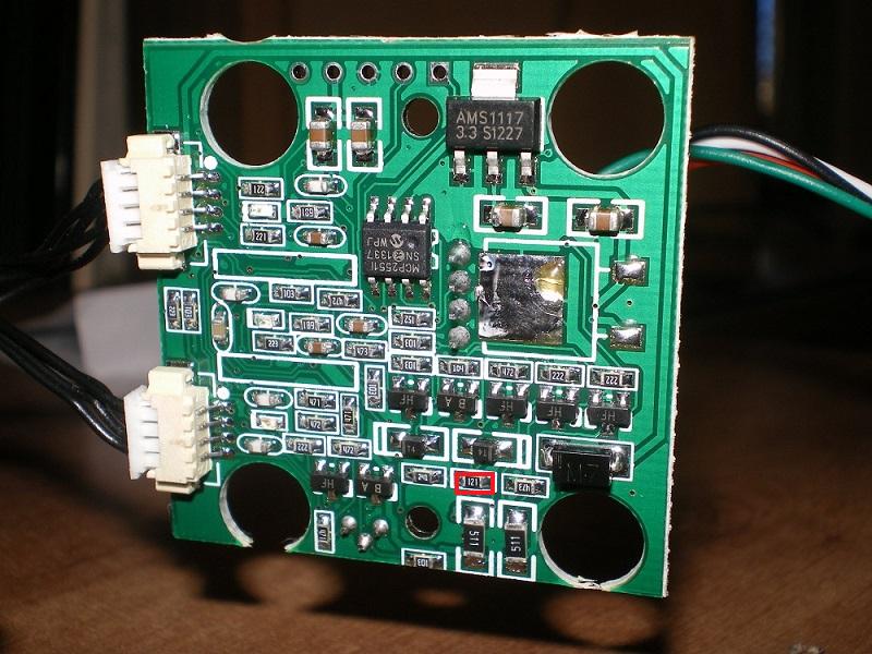

I have a 2001 Punto (MK2 - SX)
I got my ELM327 cable from this ebay link:
http://www.ebay.com/itm/400465763167?ss ... 1497.l2648
It's a chinese one.
I'm using the free version of Multiecuscan, I can connect to the Engine ECU but not the Delphi Steering Wheel.
I only want the diagnose the steering wheel.
Do I need to fix my ELM cable like in the pictures? or the Steering Wheel section should work without any changes?
This is how my PCB look like:
Posted: 22 Apr 2014, 17:18
This interface we had already several times here
Remove the red marked Resistor and you would have to also be able to read your steering control.
149z39j markiert.jpg (100.93 KiB) Viewed 8860 times
Posted: 22 Apr 2014, 17:22
by idan182
Thanks Eddy! will try that.
Posted: 22 Apr 2014, 17:25
idan182 wrote:Thanks Eddy! will try that.
Please :D
And report here if it works now.
