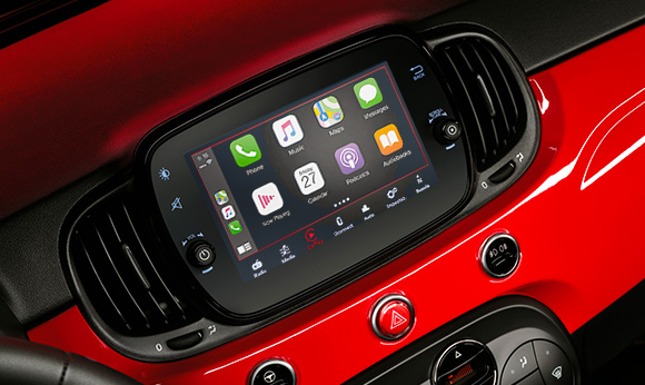

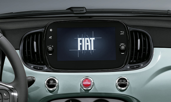

I finally managed to gather everything needed to swap my Uconnect 7" for a version with DAB and CarPlay, and overall, it worked out quite well.
Here’s the Proxy config before the modification:
33 32 31 35 30 30 32 36 39 35 37 4F 55 54 50 55 54 44 4A 49 54 20 17 03 06 4F 8C 00 05 10 00 00 00 09 00 00 04 10 00 00 00 83 42 71 06 DB 20 1C C0 00 00 00 16 00 01 00 94 06 41 01 00 40 00 81 00 75 41 0A 0C 0D 01 80 2E 24 00 00 00 00 32 25 18 03 00 00 04 00 00 00 00 00 00 00 00 00 00 00 00 00 00 00 00 00 00 00 00 00 81 10 94 08 52 30 04 95 02 00 20 80 00 00 70 00 81 00 0F 00 00 00 00 01 00 C0 01 00 00 00 00 00 00 00 00 00 00 00 00 00 00 05 00 00 00 00 00 00 00 00 00
And here’s Proxy config after the swap:
33 32 31 35 30 30 32 36 39 35 37 4F 55 54 50 55 54 44 4A 49 54 20 17 03 06 4F 8C 00 05 10 00 00 00 09 00 00 04 10 00 00 00 83 42 71 06 DB 20 1C C0 00 00 00 16 00 01 00 94 06 41 01 00 40 00 81 20 75 41 0A 0C 0D 01 80 2E 24 00 00 00 00 32 25 18 03 00 00 04 00 00 00 00 00 00 00 00 00 00 00 00 00 00 00 00 00 00 00 00 00 81 10 94 08 52 30 04 95 00 00 20 80 00 00 70 00 B1 00 0F 00 00 00 00 01 00 C0 01 00 00 00 00 00 00 00 00 00 00 00 00 00 00 05 00 00 00 00 00 00 00 00 01 00 00 01 00 00 00 00 00 00 00 00 00 00 00 00 00 00 00 00 00 00 00 00 00 00 00 00 00 00 00 00 00 00 00 00 00
I’ve deliberately kept DAB disabled for now, as I don’t have a DAB antenna yet and still haven’t figured out where it’s located in the 500C.
However, there are three things I couldn’t sort out:
1. Along with the new Uconnect 7", I also swapped the AUX+USB connector box for a USB+USB version. Now I’m stuck with this and can’t figure out how to change it:
* Aux Presence: 0x1 → 0x0
* USB Presence: 0x1 → 0x2
2. I’d like to keep the welcome screen from the new radio (the modern style). I know it’s controlled by Byte 130, but I haven’t found the correct value to enable it.
3. And finally, how do I enable widescreen CarPlay view?
