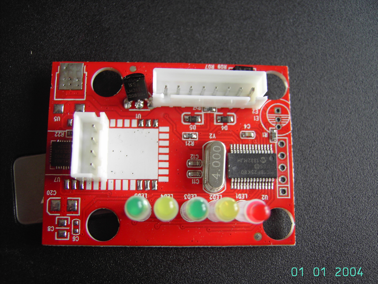

I bougth a wifi ELM327 and remove the resistor that you mentioned marked in the picture.
However I take the same error:
Wifi connected to 192.168.0.10:3500 OK
but than "Interface not found"
Are there anything to do for this interface?
Thank you..

1- The 121 Ohm resistor formed a bridge between pin 6&7 of MCP2551 (Pin 6-14 of OBD), and I removed this.
2- I want to use this interface on Grande Punto. (Engine ECU and Selespeed ECU)
When I look at the board I do not see the 100Ohm Resistor+ 560pF cap. ?
Is it true to add these missing parts to use on Grande Punto?

by reeper72
cant find my board on hear cant see ro4 :( the board is red no writing on it tryed to up load picture need help please
