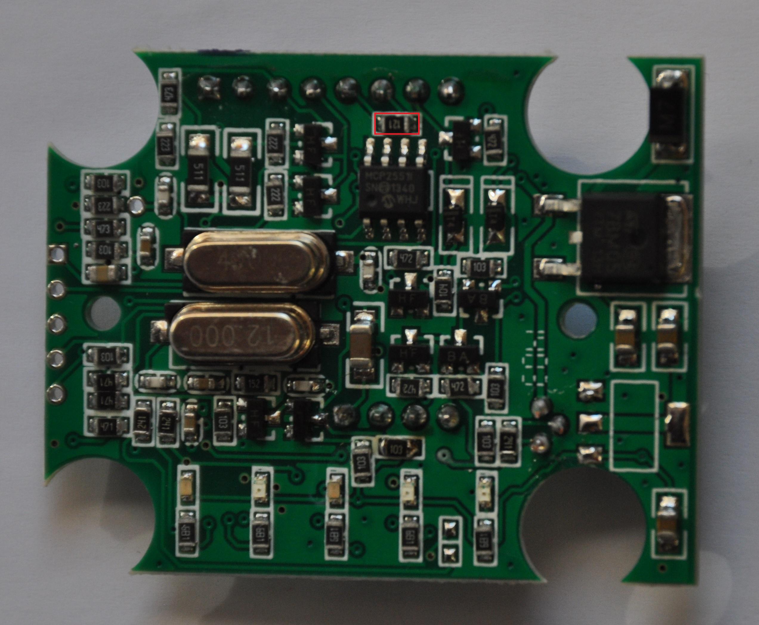

I bougth a ELM 327 1.5 ( USB version )
Can you show me wich resistor i have to release?
elm 327 1.jpg (1.05 MiB) Viewed 7704 times
Best regards
Svene
Posted: 13 Mar 2014, 12:42
Hello Svene
The red marked resistor is responsible for the CAN Bus Problem
remove this and your ELM can read logs with MES also CAN bus.
What control to which vehicle you would like to read and write?
elm 327 1 markiert.jpg (427.59 KiB) Viewed 7701 times
Hello Panda500
On your ELM Interface it is the same Resitor

Thank you. I gues it could be the marked 121 resistor,but I was'n sure so thanks for your fast answer
