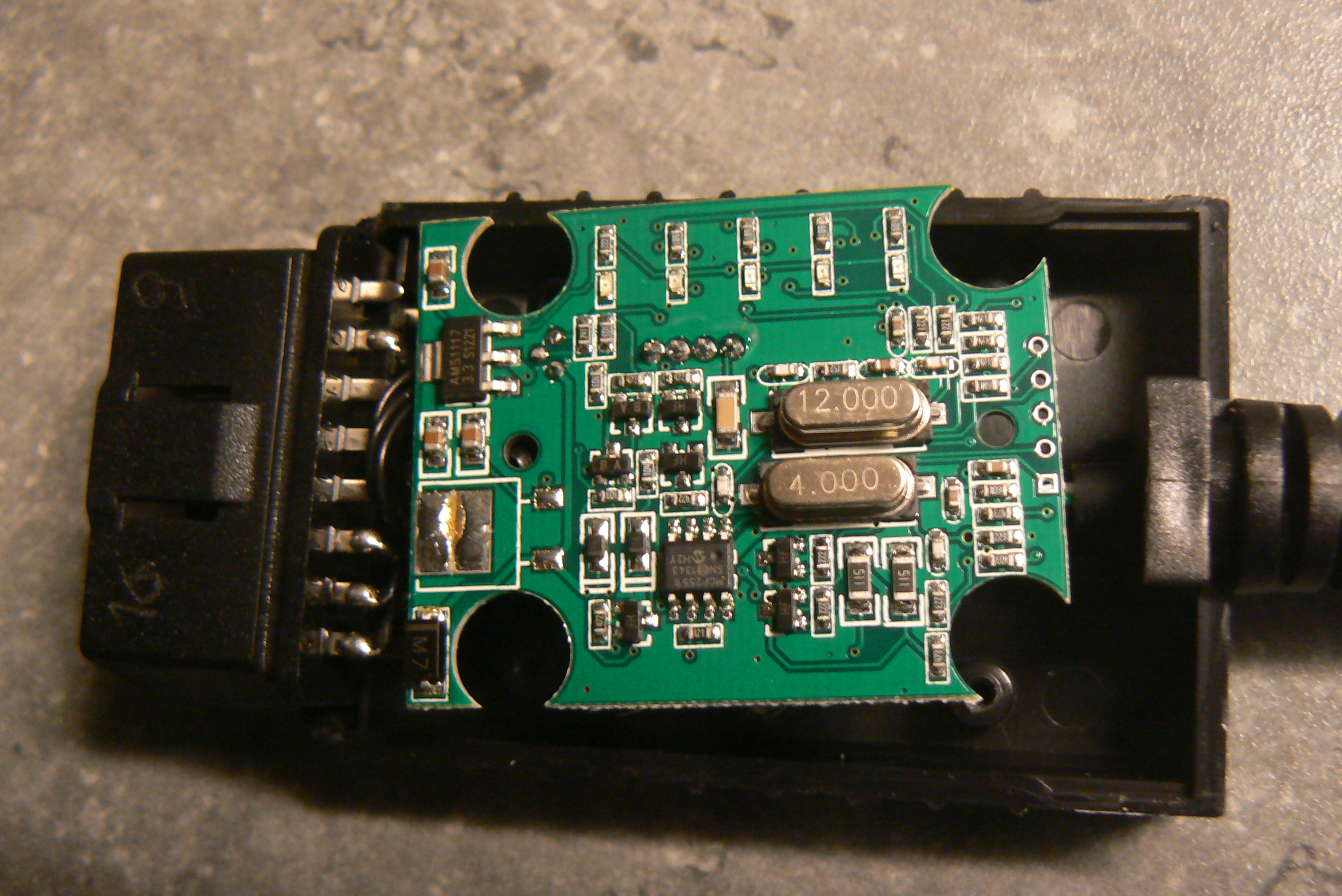

I recently bought a chinese ELM327, and it seems a far more recent version than what I can find on this forum. However, I think (and measured) the 120 ohm resistor is still present between 6 and 14. As I get normal program display when connected, correct USB port too, but tha a message that it could not connect, I assume I still have to remove the 120ohm resistor (actually I measure 121 ohms, and it is in fact written on the SMD)? Is it the part , at the picture in the middle at the bottom side, below the 8-pin IC, similar to what you showed as IC3 on your very first explanation of nov 2009?
I want to use it on a Fiat Panda 4X4, 1100cc, 1996, with SPI and Weber-Marelli CPU, with the Fiat 3-pin connector cable. It is listed as useable with the ELM327... I realize it will only give limited information (rpm, ignition info,...)
of course, because of 1996...
Thanks for confirmation or correction.
