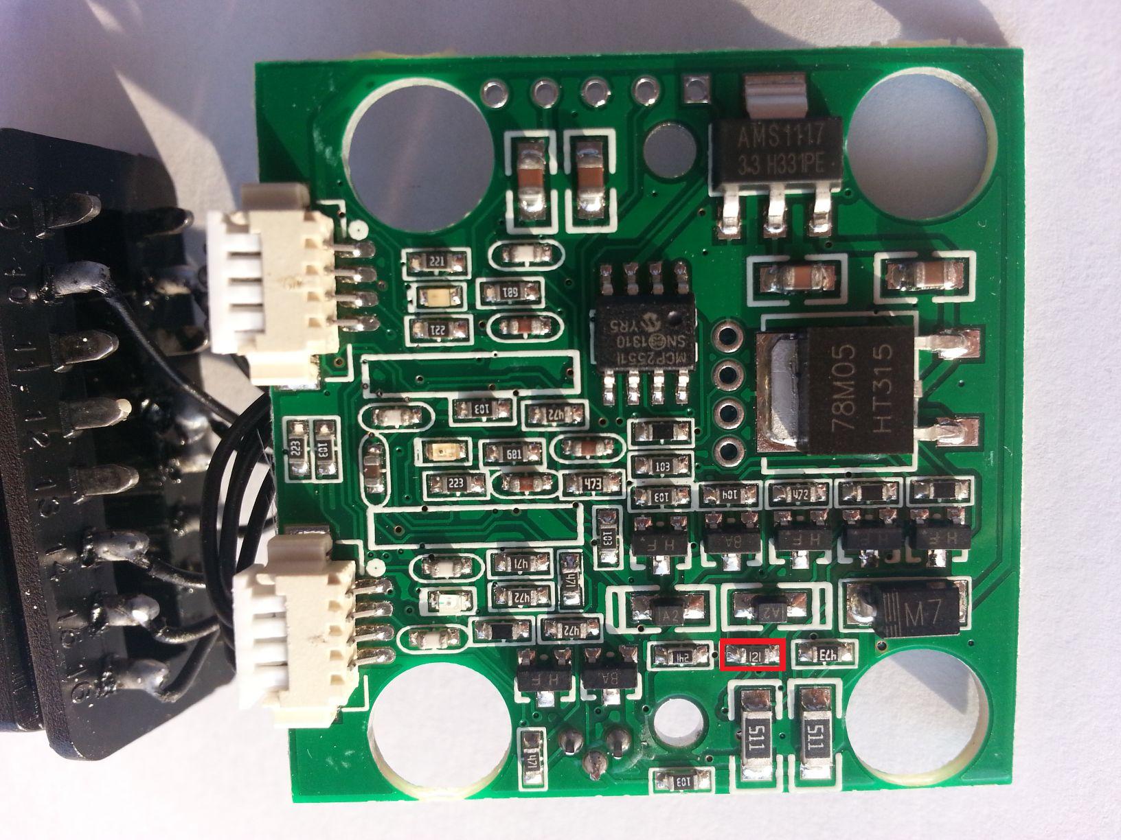

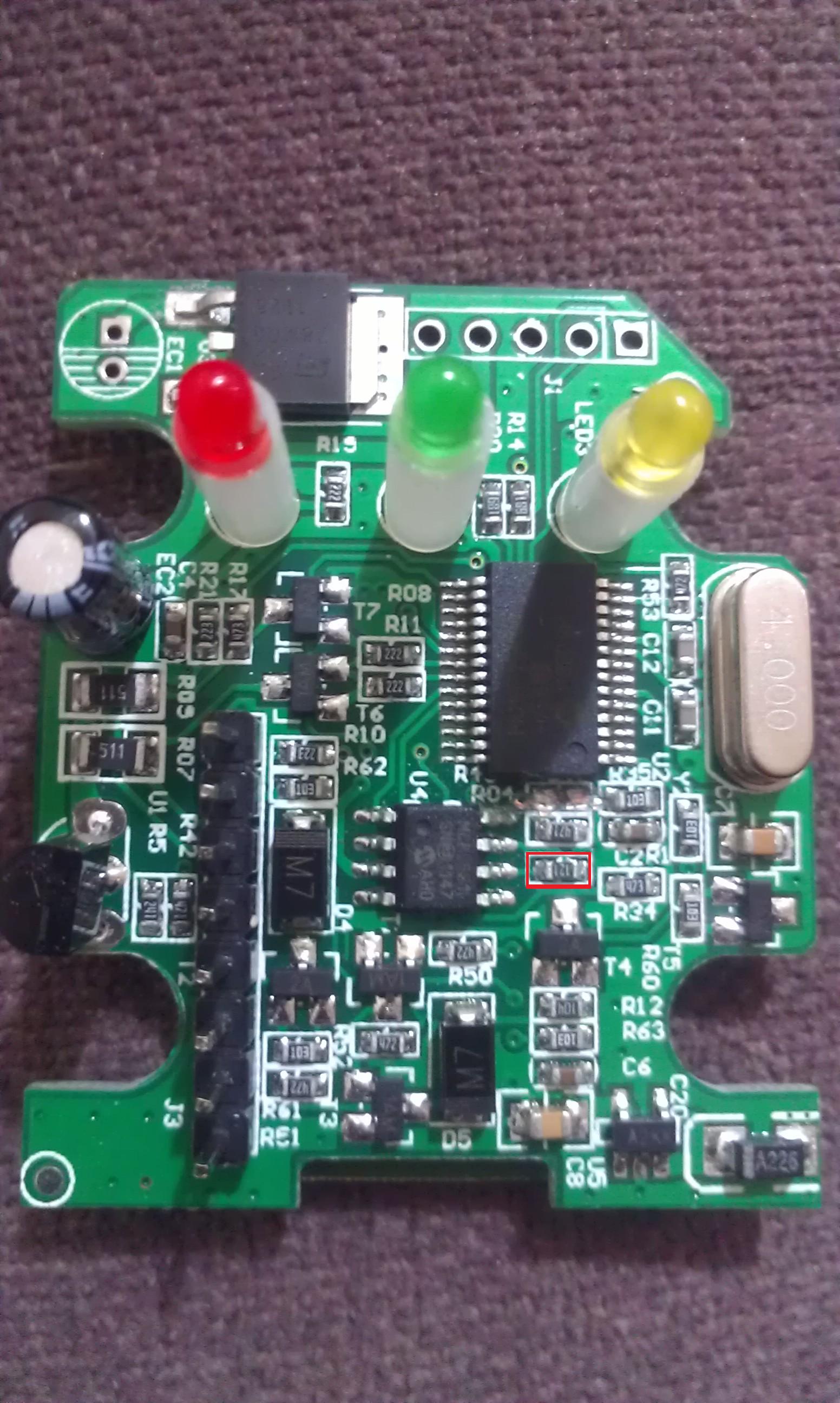

Hello Juanito
Have you removed the resistor is the wrong one! :(
Not R04
You would need to remove the red marked resistance.

Alfaeddy wrote:Hello Juanito
Not R04
Hello Alfaeddy. Thanks for answers.
There's no red in the resistance of my elm.

Hello Juanito
I forgot one put the image, sorry
IMAG0391 markiert.jpg (379.78 KiB) Viewed 7028 times

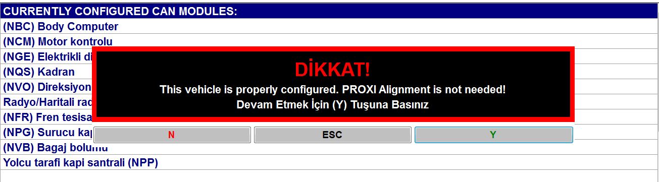

Thanks for the answer but my problem is not finished
Ekran Alıntısı.JPG (95.04 KiB) Viewed 7021 times
Posted: 25 Feb 2014, 05:49
Hello Juanito
Which Probelm?
There is but only, that is the proxy alignment OK.
And that is not necessary a realignment
And as I see yes you can also connect to the CAN setup produce.
So is your resistor problem no longer exists.
Posted: 25 Feb 2014, 07:15
by juanito
there is write proxy alignment is not needed. i cant execute proxy alignment procedure and i cant open cruise control light. thanks
Posted: 25 Feb 2014, 19:53
Since I've read that right! :lol:
Why should a proxy alignment be done? ;)
If there is no need. !
That does not make sense, does it not?

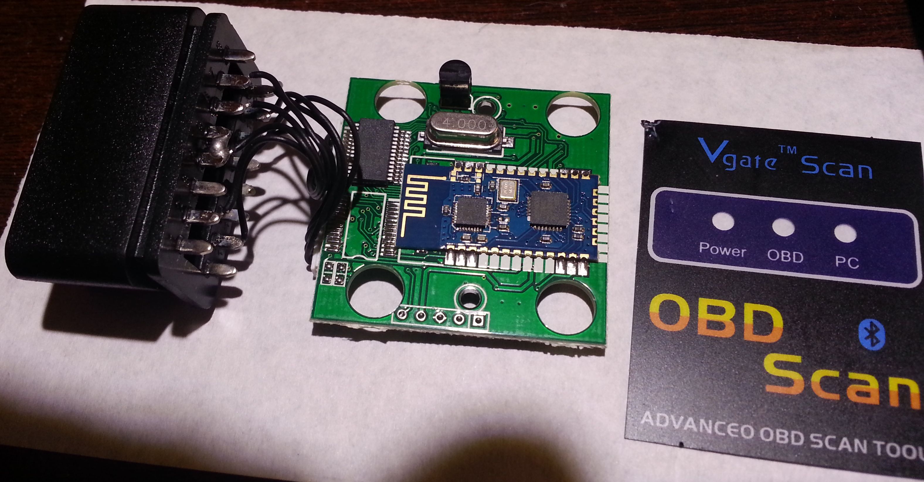

Hello Eddy,
just got an Vgate Scan Bluetooth Advanced OBD Scan Tool but it connects only to the engine ECU.
Some pictures attached:
Please help me identify the resistor that should be removed.
Best regards!
Posted: 26 Feb 2014, 20:14
Hello Arheu
Very good pictures!
So does the view joy :D
Which vehicle would you like to read?
When it comes to the often described here CAN bus problem
you should remove the red marked resitor
