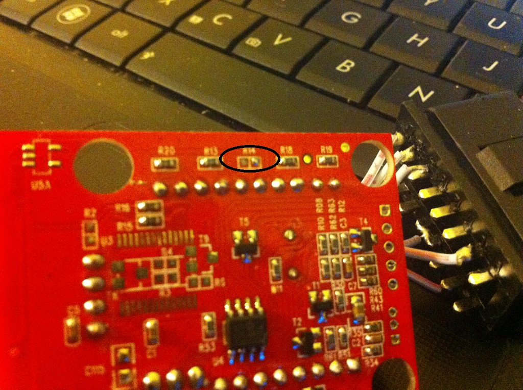

Hi, I ELM327 v1.5. I removed R14 as described in the tutorial but i cant communicate with body or service reset on dash board Alfa 147.Dar in turn can and I could not connect to motor.Sa try to remove and R04 I saw that some of the work. Thanks
Hello XCATale
The Resistor R14 must not be removed!!
This is wrong
I have also repeatedly described the
the user is not just any will remove a resistor.
OK, the thread is very long, but your ELM will be sure already described
Or send an email with better image
This is wrong
Yes I know, now I'll have to redo R14. The problem was R04

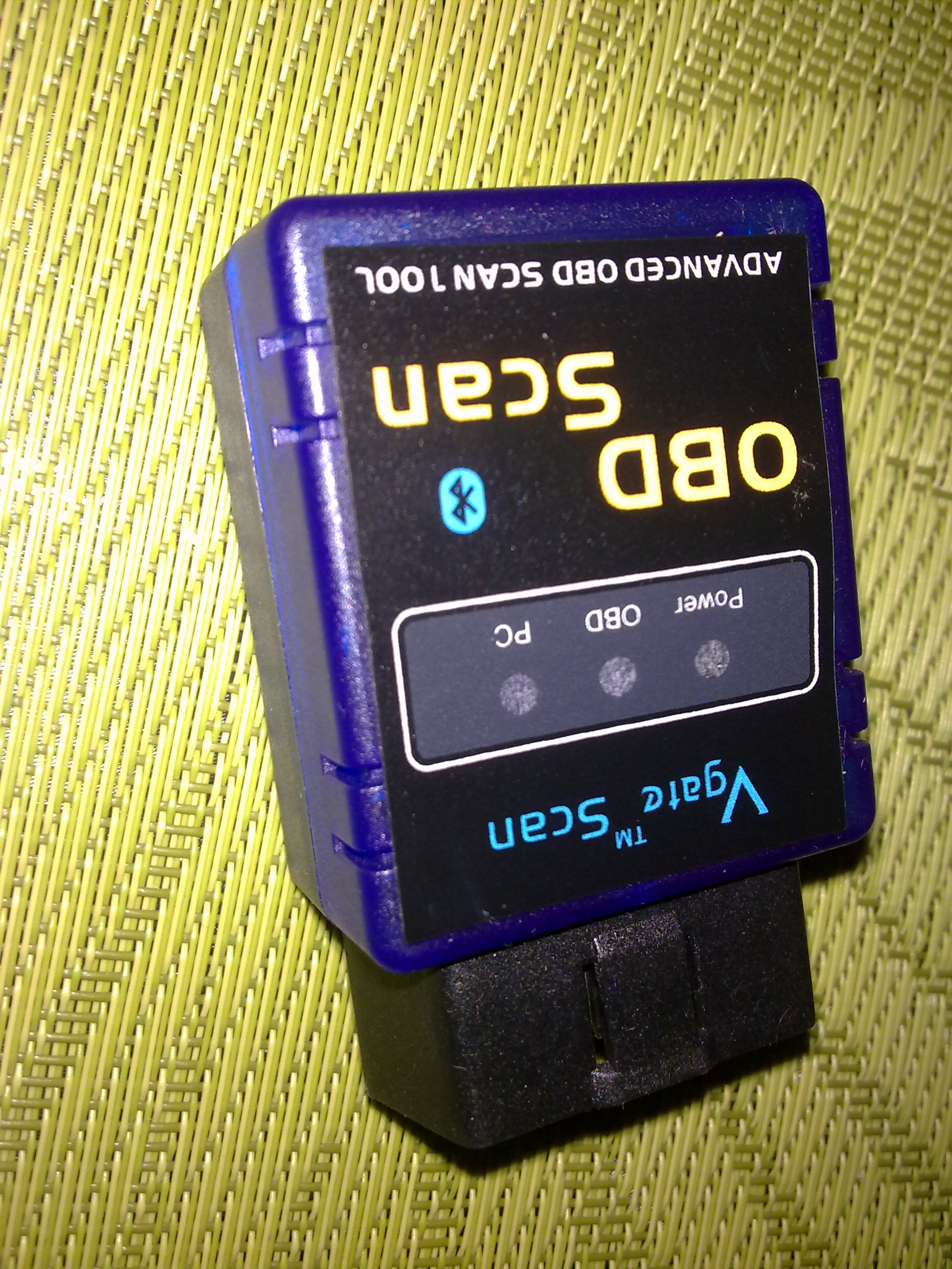

I have a Fiat Linea 2009 petrol Indian model.
I got one OBD scanner BT as per the pic below. I am not sure if you have already covered this version already.
When I connect to PC, it automatically installs the BT driver. But Multiecuscan could not find any any device.
Could you please tell me if it is the same R4 removal error?

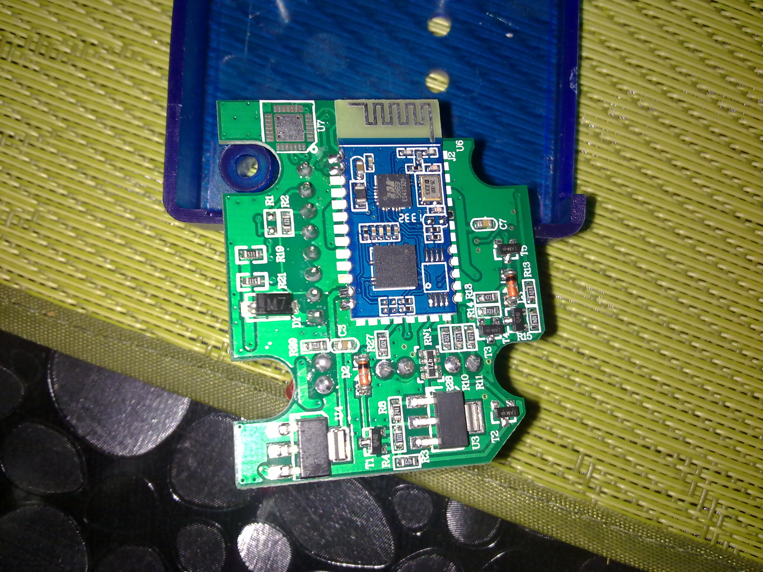

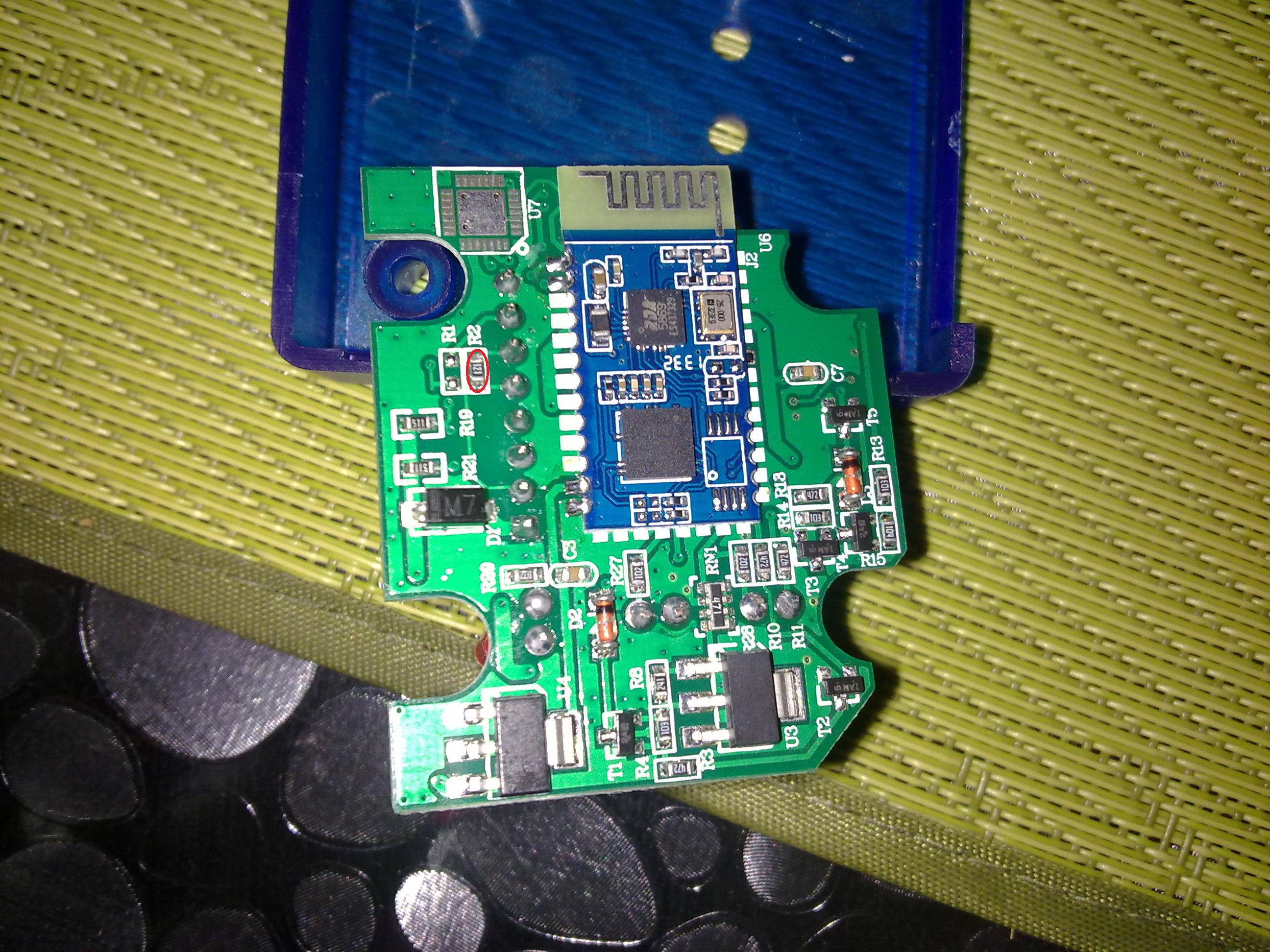

Please find the PCB pictures below.

Hello Mishradk
With this interface to connect to engine ECU, ABS must (with green adapter)
be possible. !
At your Linea
Without modification!
Otherwise, the setting or the driver are incorrect.
If the COM port of the interface identified without error?
you can see in the control panel of the PC.
But you sure you want Airbag, Body, Dashboard, service, etc. Read
also your interface R2 must be removed.
