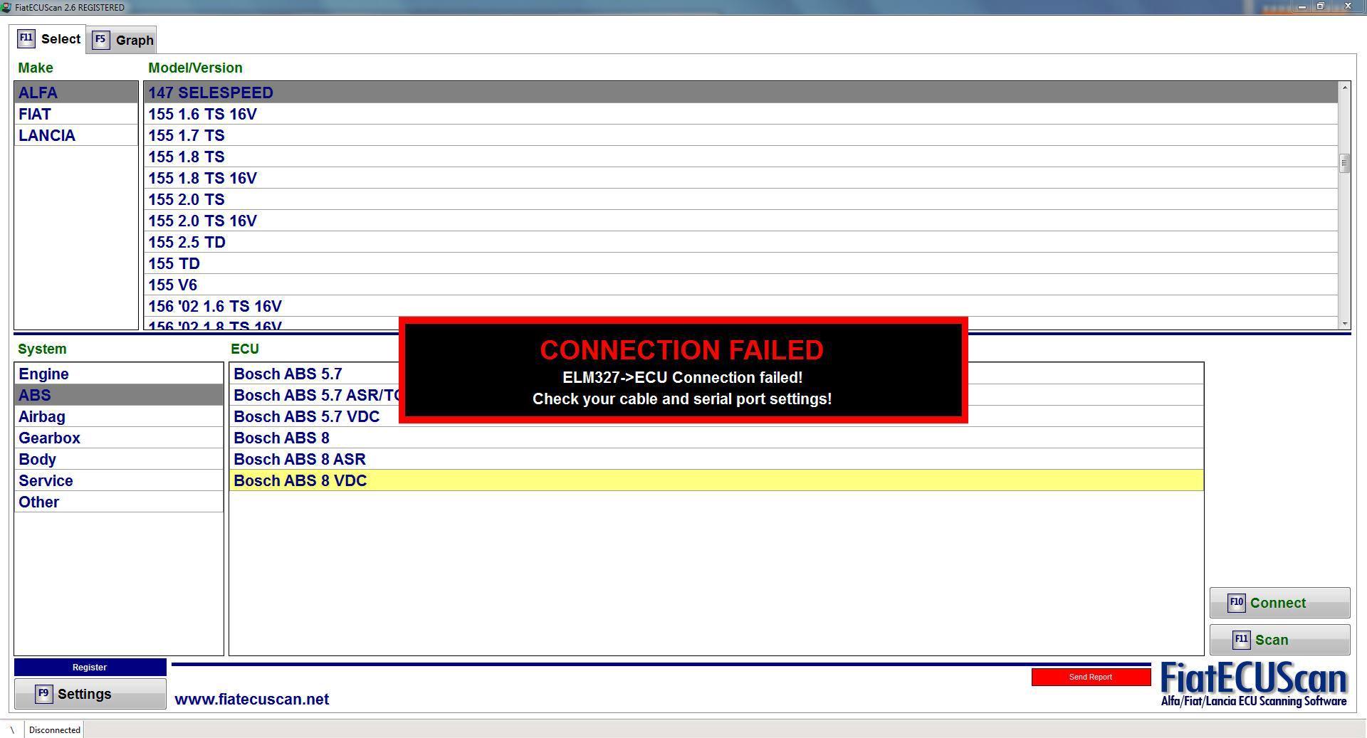

Hi,I'm again... :(((((
ABS,ASR,VDC not connect ELM327. I added Photo .
But,ELM connect to Body computer as finally.(a situation a little better.)
Do you think I take a new wire.
Do you think,I taking to VAGCOM cable for ABS,ASR,VDC.

M8 for ABS you need to solder pin 7 and pin 1 together.
The ABS in your car it is not on CAN it is an K-line
You can connect to your engine ECU?

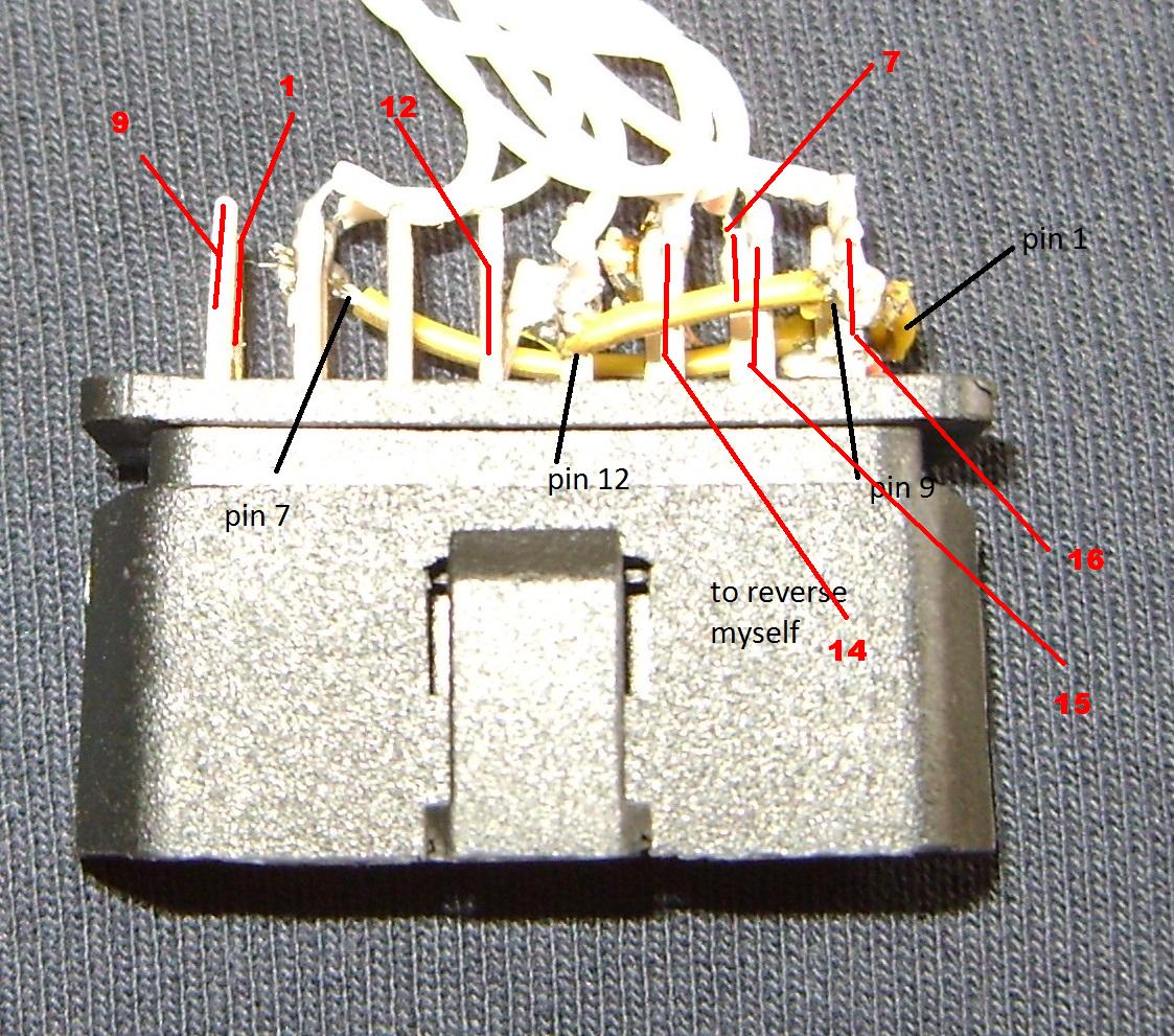

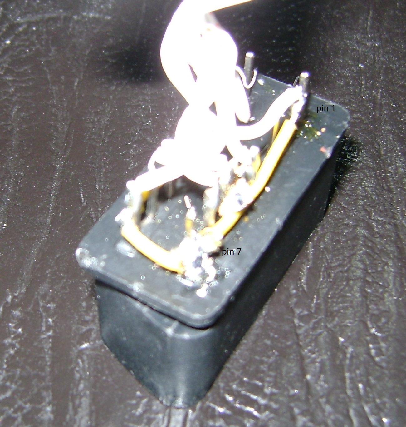

osmangdk
Posts: 10
Joined: 27 Jul 2011, 12:52
Post by osmangdk »
I know. Multiecuscan interface types, choose K-line interface. This right?
I do ELM1 (1-7-9-12 solder).Add the photos.Is there anything else?

Hey
What are you did there mate?
It is wrong
Unsolder it because thaat aren't the pins that you think there are.
You solder pin 1 with pin 7 and with pins 13 and pin 16. This wrong
Pins 12 and pin 9 are in the other side
The counter starts under the pin 1
I mean under pin 1 is pin 9 and under pin 8 is pin 16
In your pics pin one and pin 7 are solder well but unsolder pin 7 to 16 (9 in your pics )and pin 13 ( 12 in your pics )
Good luck and take care

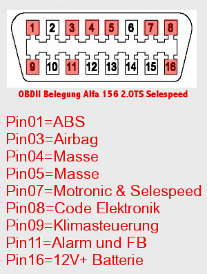

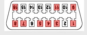

As has already written mattydr67, you have connected the wrong pins in the connector. Maybe you've already destroyed your interface. or your controller
In the picture you see how the pins are laid out, you should be careful.

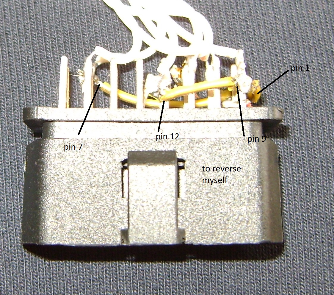

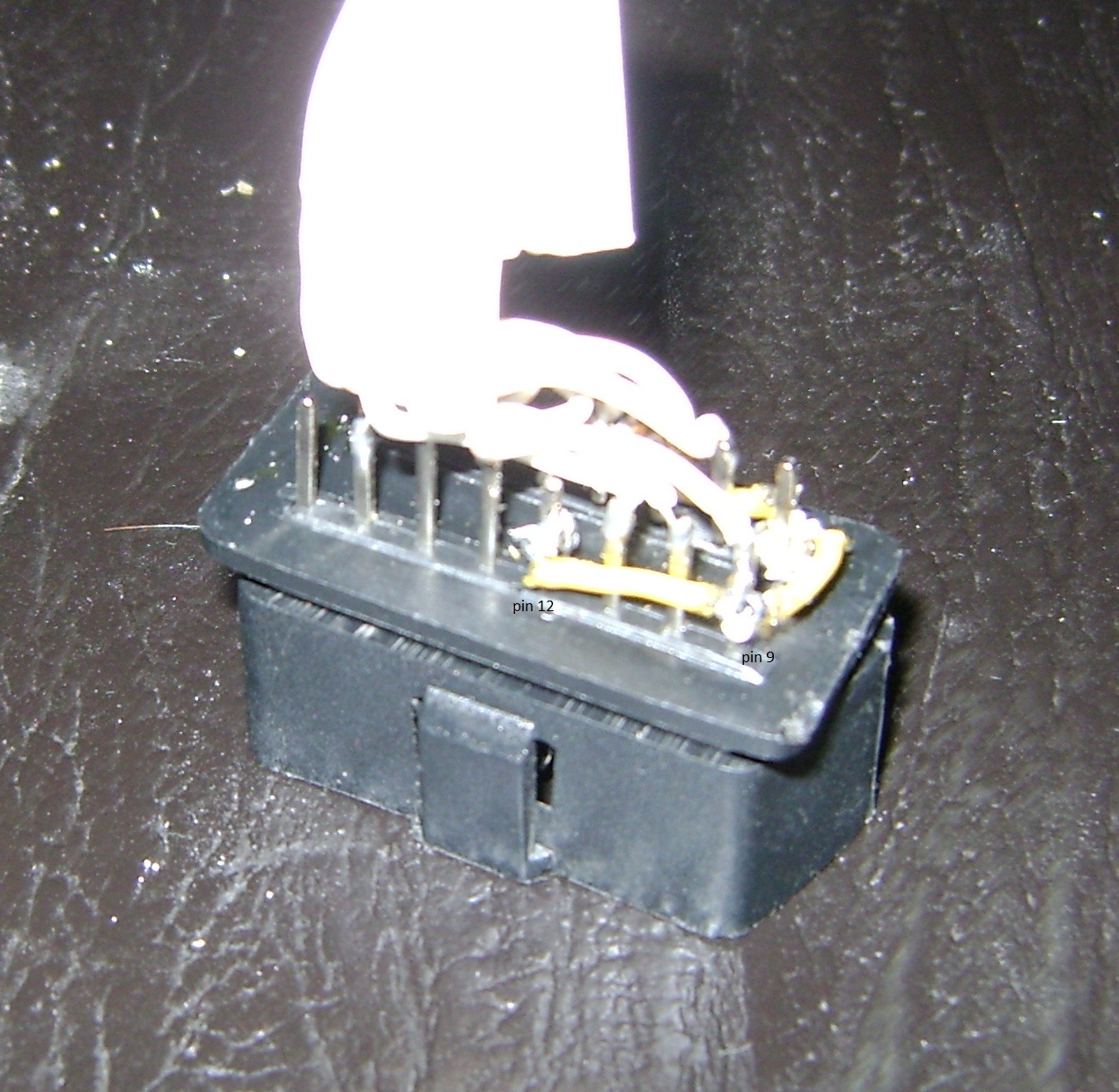

Post by osmangdk »
Hi,thank you so much,all friends.I took your time.Forgive me.My English is not good.Sorry.
Photos took in the vertical . It looks like the mirror, see the reverse.
My Photos is bad.No mymachine for shooting macro... :)
So, I really solder 1,7,9,12 pins.
Finally,I take the regular photo on elm327.Added.
But, 9 pin and 12 pin unsolder.Now,I solder only 1 pin and 7 pin.
That is enough?
Do I need to do the new solder?
problem for fear of living.
I have not tried.What do I do?
again thank you...
I do not understand how your image should be reversed?
Your joints are wrong
The symbol of me is not the socket of the connector
So imagine you put your plug into the OBD socket, and then counting
from the pins.
Auserd you can also connect the pins 8 and 11 and 13 still with.

Take a look here mate
osmangdk
Posts: 10
Post by osmangdk »
See the photo this way.cable, such as the photo turned upside down.
May need to do another solder pin here?
