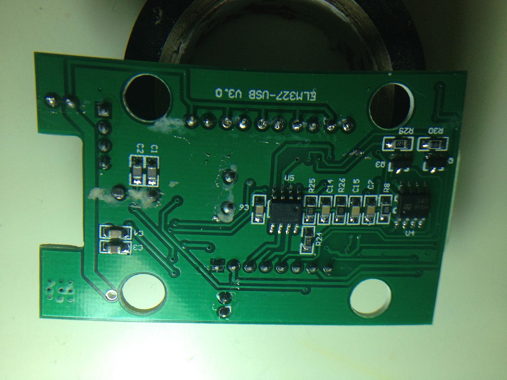

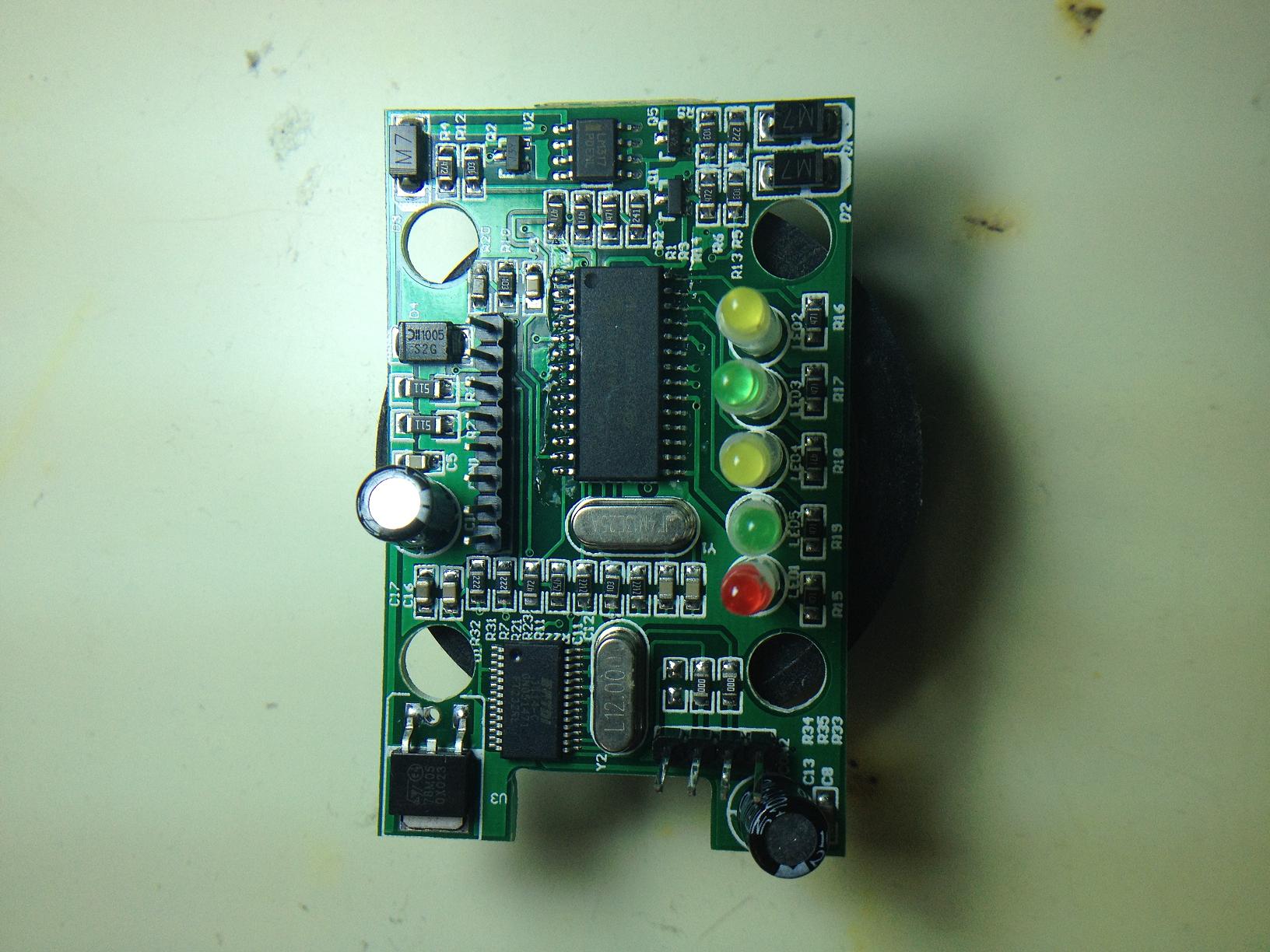

on my orange and blue ELM 327 a lot of pin's are not wired
pin 8 1 3 9 11 12 13. 4&5 are briged together to one wire. Is it normal?
http://imageshack.com/a/img843/474/3msh.jpg
http://imageshack.com/a/img689/7466/nu3c.jpg
http://imageshack.com/a/img545/7797/nbv5.jpg
I plan to connect on my FIAT STILO 2006 Mjtd. Do I need to make any
modification to this board?

It is normal, you must remove R121 on foto http://clip2net.com/s/6CpL5c
Hello vmaci
I can only imagine that your settings are not correct for the ELM.
or the adapter is defective!
Or you use the adapter for the KKL interface?
Hello daniTM
How vmaci already correctly writes, remove this resistor
To be able to read CAN bus protocols.
This interface has been made ​​only for reading the Motorecus.
As this pin is standardized (pin 7) are the other pins free
Pins 4 & 5 are the negative pins (vehicle body and Chassis)
Therefore, these two are bridged

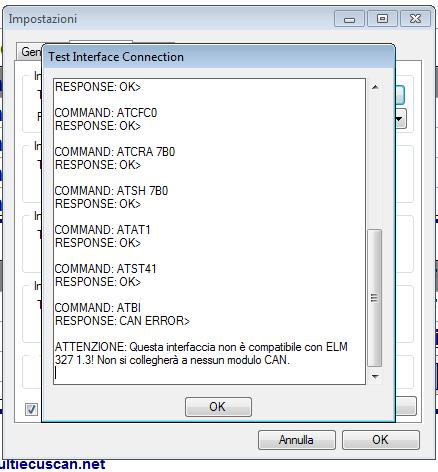

Hi guys, can anyone help me? My elm appears not to work, only access to some ECU, there is a possible fix?
BR
