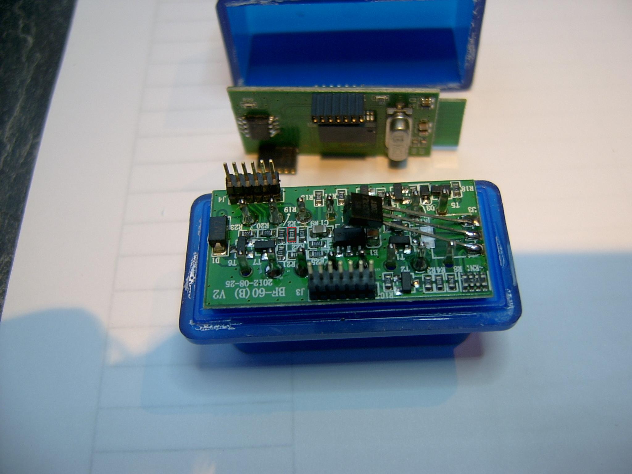

Hello, Alfaeddy, please, can you help me?
I have a alfa 159, and a elm 327 bluetooh, I have to remove r4 of my elm327?
http://imagizer.imageshack.us/v2/800x60 ... 9/rmy9.jpg
http://imagizer.imageshack.us/v2/800x60 ... 2/xisu.jpg
Posted: 12 Jan 2014, 20:18
Hello igna
Are you sure this resistor R4 and the bridge resistor is??
You can pull the upper board and then get a better picture.
Posted: 12 Jan 2014, 20:31
Hello igna
No, do not remove R4, this is the wrong Resistor
As I have already written, remove the upper board
and below is the R2, it must be removed.

Hi Alfaeddy,
I removed this morning R4 on my ELM board, and it's works like a charm ! (engine, dashboard, interval reset, body computer..) (Alfa 159 2.4 JTDm)
Thank you for your contribution!
Greetings From France!
