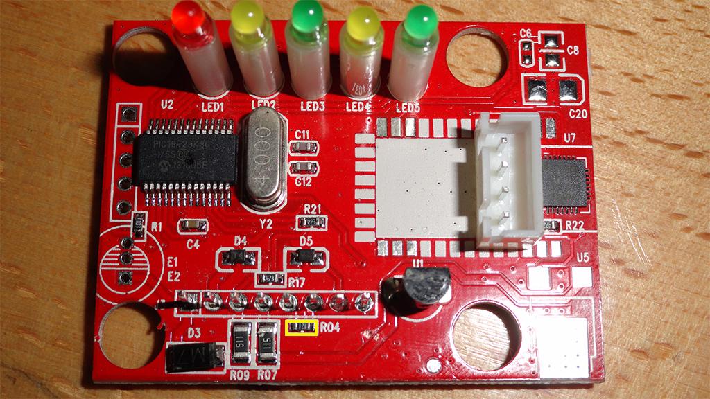

Yes, I can connect to Motor ECU and nothing else. ELM not have resistor between pin 6 and pin 14. In what could be problem?

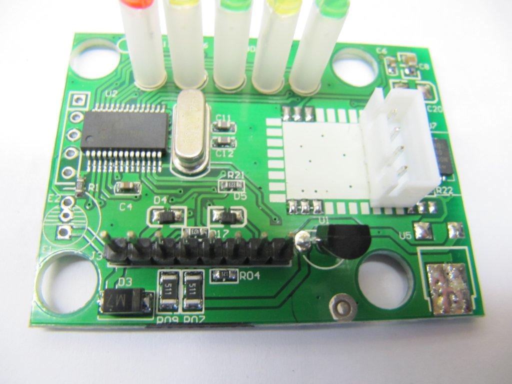

But for the Dash and Body I need an ELM327. I ordered a blue-orange 10$ chineese interface. With this I only could connect to the Engine. So I removed 'R04' 121 resistor. But my problem doesn't solved.. This was the red PCB above the forum.
I ordered a new blue-orange chineese 10$ ELM. It's a little bit newer, it has got SMD LEDs. I tested, only the Engine reachable.. OK no problem, I removed the resistor. But still no Dash, Body, etc.. I started to change the drivers, USB settings, and everything. It took hours from my life.. But ZERO progression!! At this point I started to go crazy.. I really had no idea at all!!

Hello vmaci
Which vehicle would you like to read?
If only the CAN bus protocols the problem?
Can not read at all CAN Bus controllers?
If no resistor (120 ohms) is between Pin 6 + 14
then either the interface is faulty or the controller in the vehicle
on which you can not get a connection!
Unfortunately, you have photographed only the back of the board
Why do the picture if no bridge resistor is present. ?

Same PCB is on the page 104 than yours! The resistor is on the other side, under the white connector 'R04' 121. You only had needed to read back a few pages.. :oops:

Hi!
I have Fiat Doblo 1.9 Mjet Cargo 223
Yes, can not read all CAN controllers
Sorry, I forgot upload pic. Here is my photo

Hello vmaci
Look at the white plug housing should be removable.
Among them the bridge resistor can be located
This image is not your board but you can see at which
Point, you should look
1 markiert.jpg (147.58 KiB) Viewed 12858 times
Edit :
This ELM board we had a lot of times in this thread :lol:

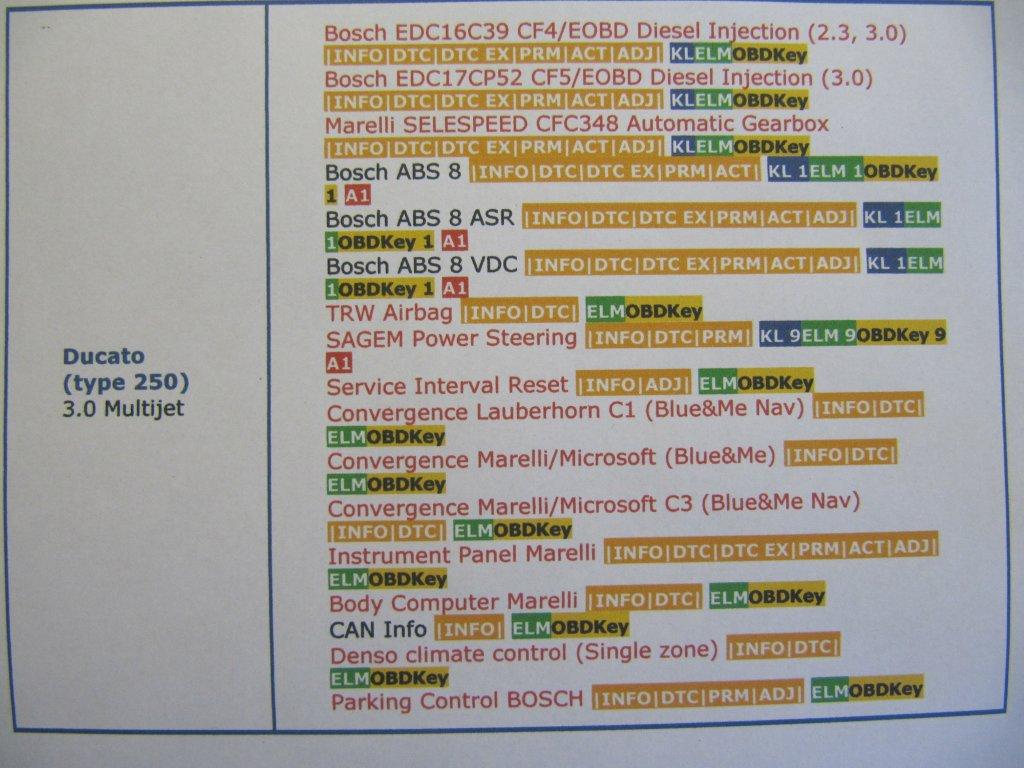

I have a ELM 327 ( see photo)
Fiatecuscan
I can connect with the ECU , but i cannot to reset the service interval.
The car is a Fiat Ducato 250 3.0 multijet ( see photo)
The ELM ( see photo)
Do i need adapter cables?
Is this also the problem of the R04?
Thank for help.
