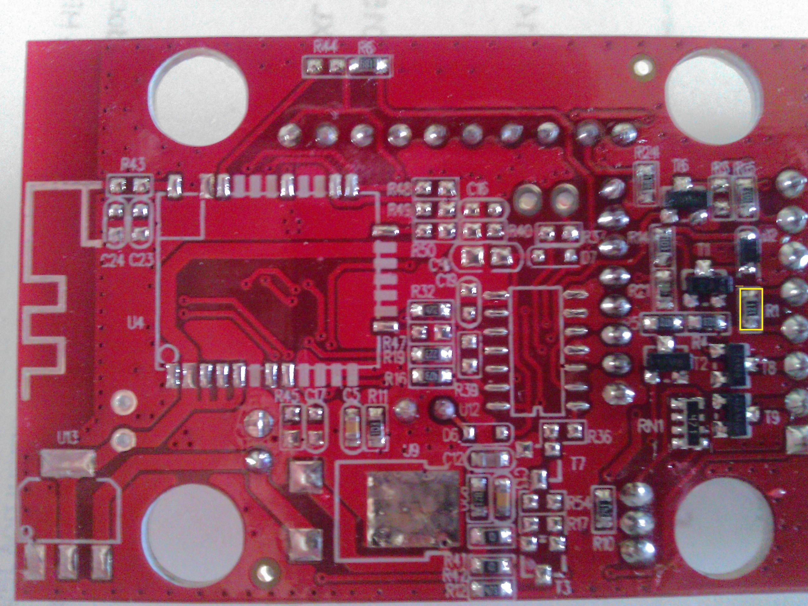

Hi Eddy,
Wonder if you could point out which resistor to eliminate on the attached pics.
Chuckster
Sorry so blurry, I will try again if you like :D
Posted: 08 Jan 2014, 21:39
Hello Cuckster
Wow. this board I have not seen
This is new to me
But if I see it right, despite the blurred image
then remove R1 in the yellow frame then it should work.
