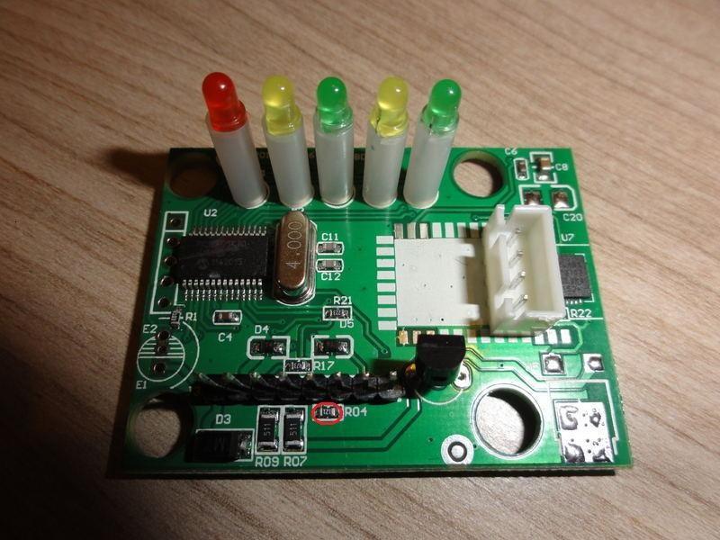

Hi I have an interface V1.5a, same picture red card in the previous post, I remove a R04 resistor, so I can connect to CAN and service interval reset, I can modify a last service date or das till next service but I CAN'T reset KM when I execute next service km reset or next oil change km reset inmediatelly I receive FAIL.
Just in case number of service are in 7 service interval 10,000 KM
Distance till next service are in 0km and fail too trying change it.
Car Info
Fiat Idea 1.8 8V year 2006
All other option work without problem.
Thanks so much in advance
Leo

Hello I have this elm327 ,can I remove only resistor 04, or must to solder some resistor and capacitor on the can line
- Widerstand markiert.jpg (92.03 KiB) Viewed 14212 times
And also have this bluetooth elm327, is there any resistor to must remove.
Thanks a lot.
Posted: 26 Dec 2013, 18:11
Hello Dean
On usb ELM is the red marked Resistor the right to be removed!
Otherwise there is nothing to change.
On Bluetooth ELM it is on the back of the board of the resistor R1 (121)
must be removed.
