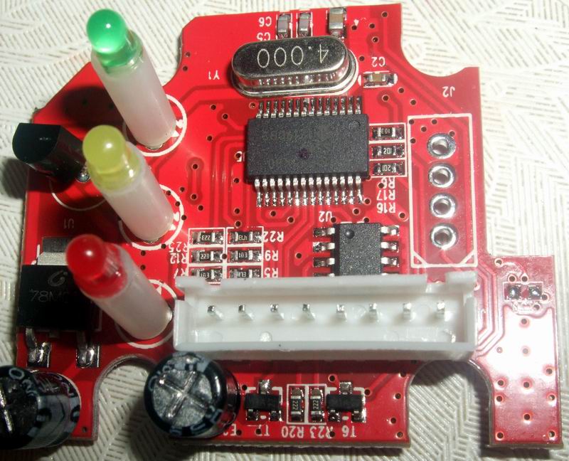

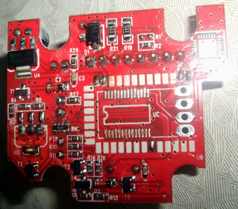

Hello I have this elm327 ,can I remove only resistor 04, or must to solder some resistor and capacitor on the can line
And also have this bluetooth elm327, is there any resistor to must remove.
Thanks a lot.
Thanks a lot.
- DSCF3524.JPG (110.67 KiB) Viewed 14194 times
- DSCF3522.JPG (98.88 KiB) Viewed 14194 times
Hello Dean
On usb ELM is the red marked Resistor the right to be removed!
Otherwise there is nothing to change.
On Bluetooth ELM it is on the back of the board of the resistor R1 (121)
must be removed.

Many thanks Alfaeddy, for the bluetooth elm, in my version the resistor R1 is removed ( I didnt remove) but still cant work can system.
Maybe is eobd plug problem pinout.
