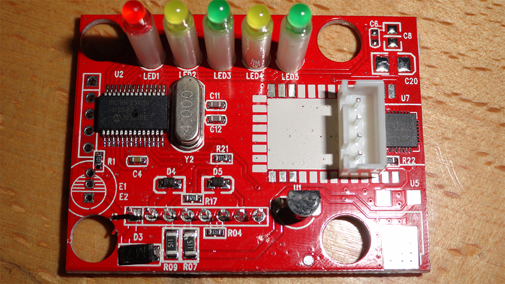

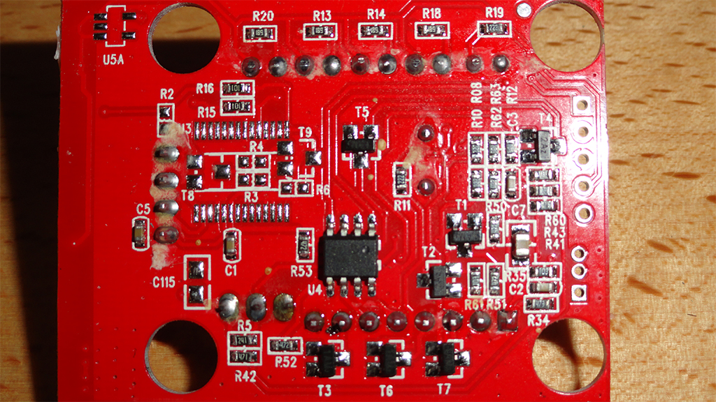

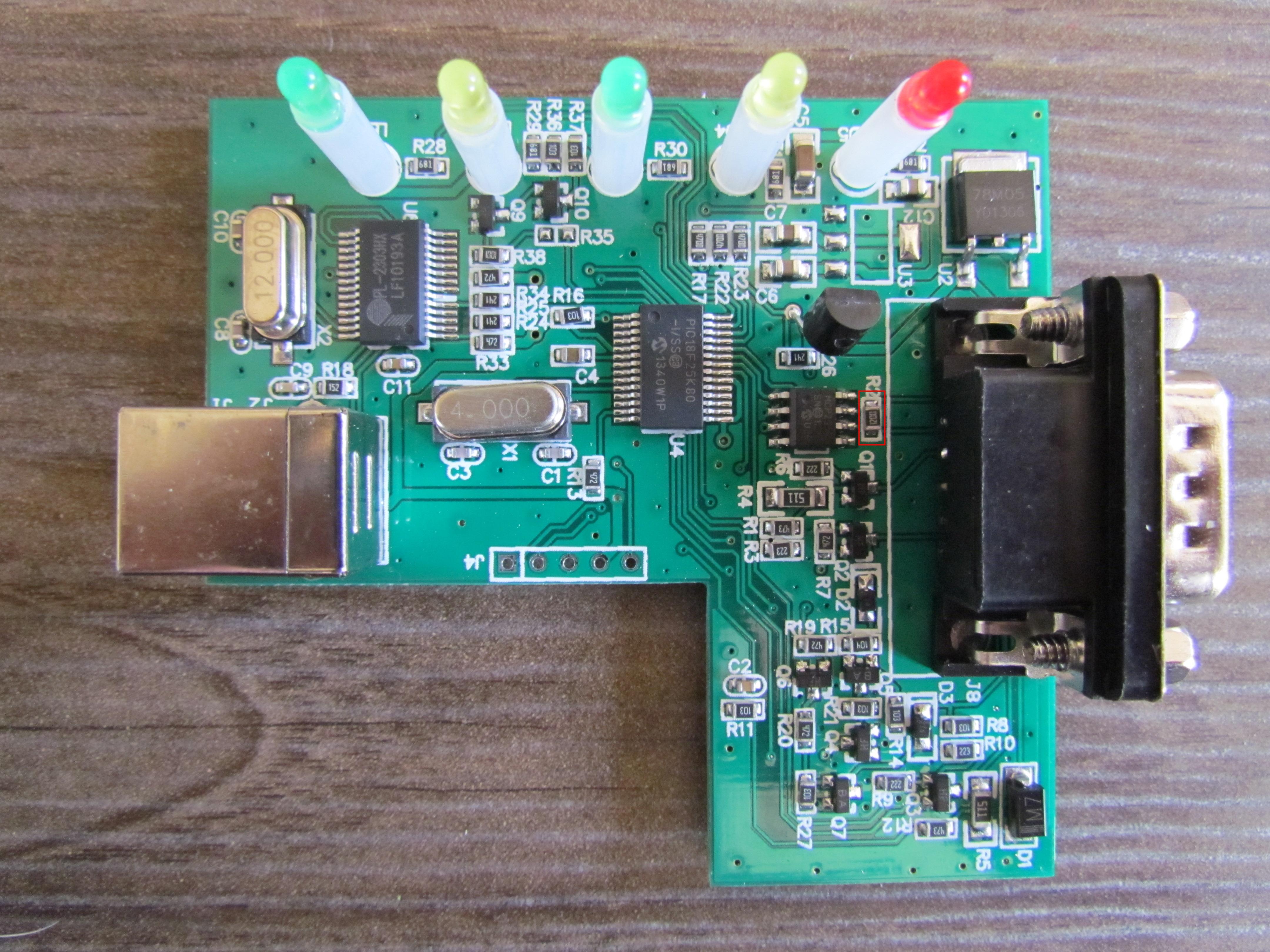

Hello everybody, can someone take a look at my ELM327 ?
I bought a ELM327 1.5 a (alu) to reset my service interval on Fiat Bravo 2 1.6 jtd.
All connection tests are OK and i can connect multiecuscan to my engine but i cannot connect to service interval reset. Multiecuscan alway's ask me to check my connection parameter or cable.
I have read lot of forums that's sayind to remove R04 resistor but my ELM is different.
I send you pictures :

Posted: 16 Dec 2013, 11:41
[quote="aulecuyer80"]Hello everybody, can someone take a look at my ELM327 ?
Hello Aulecuver80
Resitor R4 its Wrong :( , you must Remove only the Resitor R2 (1200) :D
then you can read with your Interface the CAN Protokolls with Multiecuscan.
Posted: 16 Dec 2013, 12:27
by aulecuyer80
Hello Alfaeddy.
Thank a lot for your reply !
For you, i just have to remove the r2 resistor ?
Is it this one ? (framed in red) :
Copie de IMG_77923.JPG (1.4 MiB) Viewed 9997 times
Posted: 16 Dec 2013, 12:53
Hello Aulecuver80
Yes the red marked Resistor is right
Posted: 16 Dec 2013, 15:30
by aulecuyer80
Re Alfaeddy !
I have tried your solution and IT'S THE SOLUTION !!!!!!!!!!!!!!!!!!!!!!!
Thanks a lot !!!!!!!!!!!!!!!! :-D
