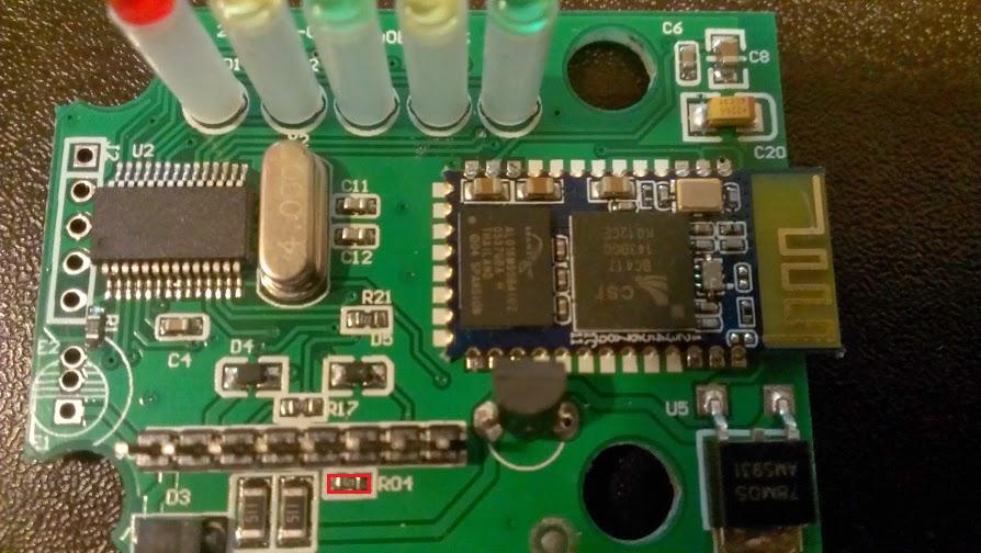

Hi guys. Hoping you can help. Trying to connect to CAN on my 147. Just need to know what I need to remove
https://lh3.googleusercontent.com/-2EQV ... AG0140.jpg
https://lh6.googleusercontent.com/-WJFq ... AG0141.jpg
Thanks in advance
Adrian
Posted: 02 Dec 2013, 15:25
What problem you have while reading your 147?
In addition, this resistor (red marked) be removed if you can not produce a CAN connection
This interface has been repeatedly described here
IMAG0140 markiert.jpg (75 KiB) Viewed 11456 times

Posted: 03 Dec 2013, 15:44
Unfortunately, there are no other possibility for you,
Open the ELM and find this bridge resistor and remove
This ELM we had several times already but here you have to look yourself
set or an image.
Edit:
Unfortunately, it is not so, which was built the same board in the same packages.

Posted: 03 Dec 2013, 22:42
Sorry in this Thread is the same Interface
and I find not an bridge resistor
viewtopic.php?f=5&t=3860#p12879
Sorry

Posted: 04 Dec 2013, 15:20
Take now please a multimeter to pin 6 and pin 14 and measure the resistor between two pins
Then you can measure whether a bridge resistor is present.
Edit:
Otherwise, I would have the board in front of eyes to see the curves.
I had already tried unsuccessfully in the other post
