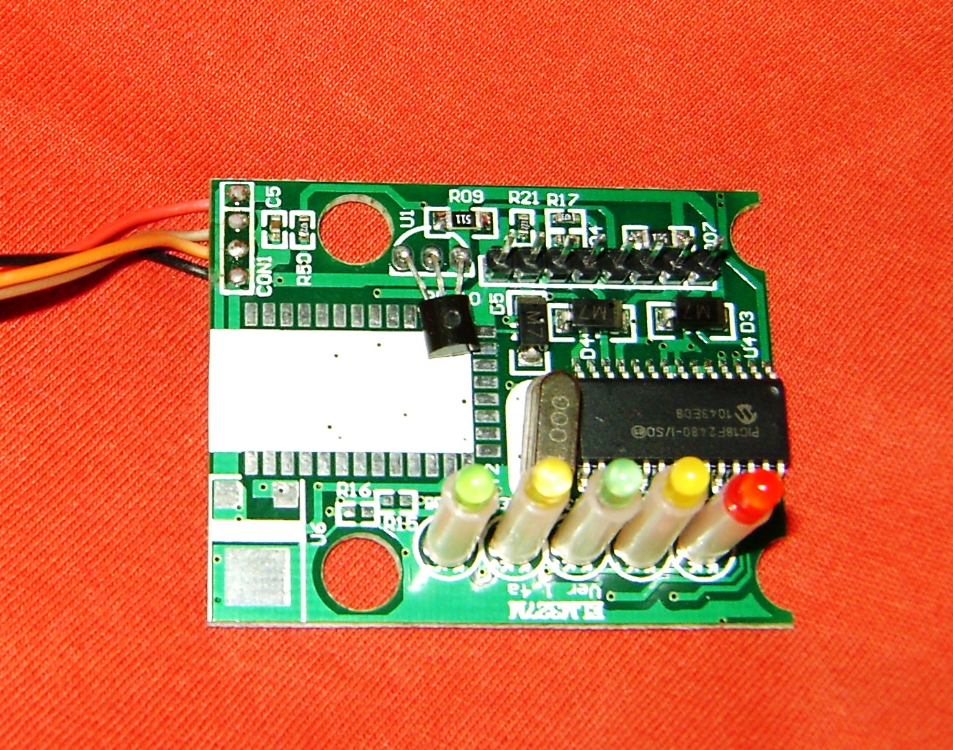

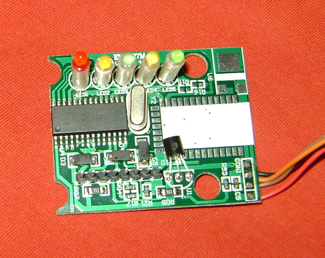

Posted: 28 Jul 2011, 17:18
by osmangdk
Hi. Thank you for answering my questions.
I added board photos ELM327.
There are two things in a different resistance.
How do you think?
Do you think should remove R04.Thank you.
ELM327 V1.4+ mi acaba :)
ELM327 V1.4+
ELM327 V1.4+
Posted: 29 Jul 2011, 05:35
by mattydr67
Hi m8
Yes remove the resistor R04 like Mr. Alfa156sarajevo said and all will be ok.
You're interface will start to work on CAN
Posted: 29 Jul 2011, 07:25
by osmangdk
Thank you for everything.I tried.
