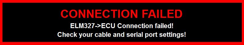

I have a registered version of the 2.1 using a elm 327 and cannot get into the service reset at all. Tells me to check cable or com port. I can only access the engine parameters but no abs,airbag or service?

see attached

Have you strapped the pins up? You need to perform the same modification as described for the KKL cable to access the various ECUs.

it connects fine to motor just not to service
