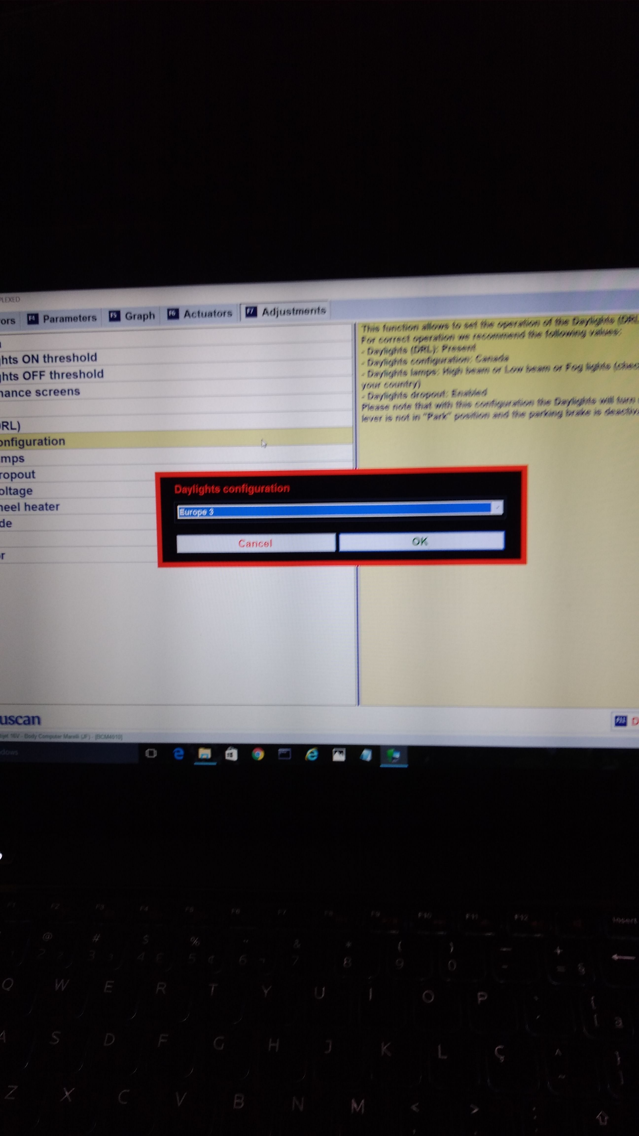

Thanks a lot for the information. Can you take a picture of the Uconnect menu and settings when Europe3 is enabled.
haffonso
Posts: 33
Joined: 20 Jun 2017, 22:37
Re: DRL settings for freemont failure on 3.6
Post by haffonso »
sppmaster

Just wonder how it is going to look on 4.3 screen.

haffonso wrote:find the screen whre the drl should be configured
for Canada choose Canada.. if wish to control from uconnect use Europe 3.
If you choose Europe 3 where in the Uconnect menu the setting to control DRL shows up.
I've just activated the DRL with latest v3.7.
