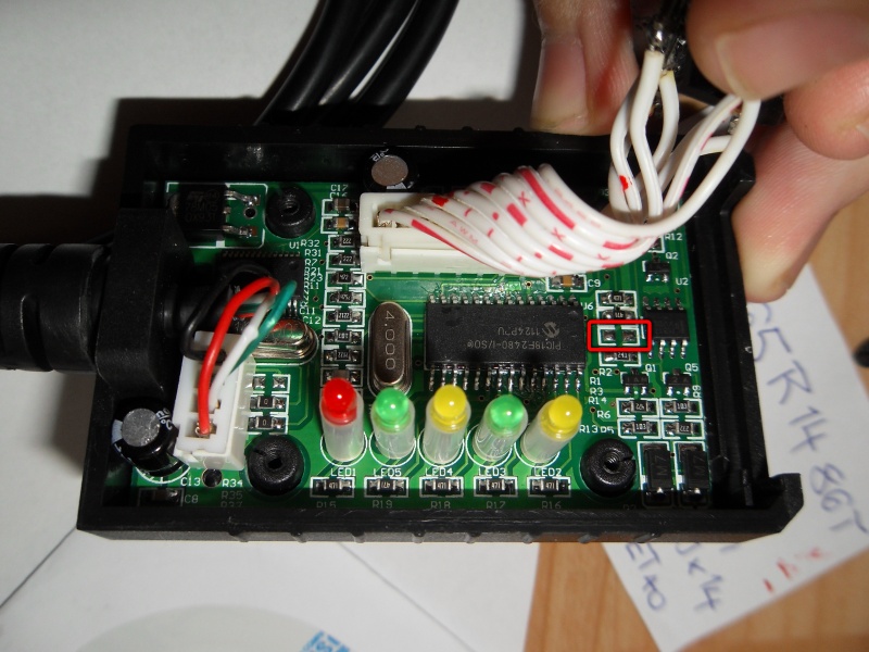

Hello, I've bought new elm327 and I have same pcb, except one missing resistor, different type of obd cable connector and I have connector for usb cable inside. Maybe the missing resistor on my pcb is the same, which kris removed. So here is the picture with missing resistor:
missing resistor on my version

thanks for helping, i removed it but nothing changed. can line not working, k-line working fine
peppino
Joined: 15 Nov 2011, 22:04
Re: ELM327-USB V3.0
Post by peppino »
@nickromano maybe you don't remove the correct resistor. This resistor should be 120 Ohm, 121 written on smd resistor. This resistor is between the CAN-L and CAN-H is simple to understand it. Pin 6 and 14 of OBD connector.
