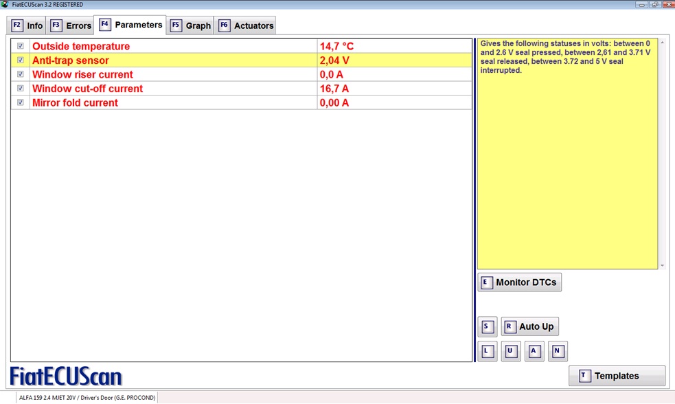

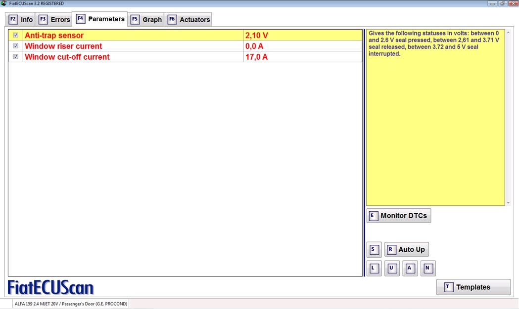

Yani, I would like to ask, how similar are the body computers from Brera, Spider and Alfa 159. I'm asking, because I have situation like that: for now I've got a Spider Nuova (2007) 2,4 JTDm. It is not supported by FES, but I did Proxy Alignment from Brera 2,4 JTDm, and what I've observed is:
- I've got automatically folding mirrors which is very good:)
- I've lost on-screen indicator when I'm opening or closing a sunroof which is bad:(
additionally, earlier I've added an on-screen parking indicator and I've made a proxi alignment from 159 and it does work (which is either very good:)).
One more thing which I cannot run is closing windows from a key. I've got anti-trap sensors, and it seems they are working, becasue I have correct voltage on it (look for the screens below):
- drivers_door.jpg (88.96 KiB) Viewed 37138 times
- passengers_door.jpg (91.49 KiB) Viewed 37138 times
So I don't really know why it still doesn't work. Any ideas?
And about auto folding mirrors, I think only way to make it work is copy this function from Brera/Spider computer to 159 computrer. If it's possible ofcourse.
