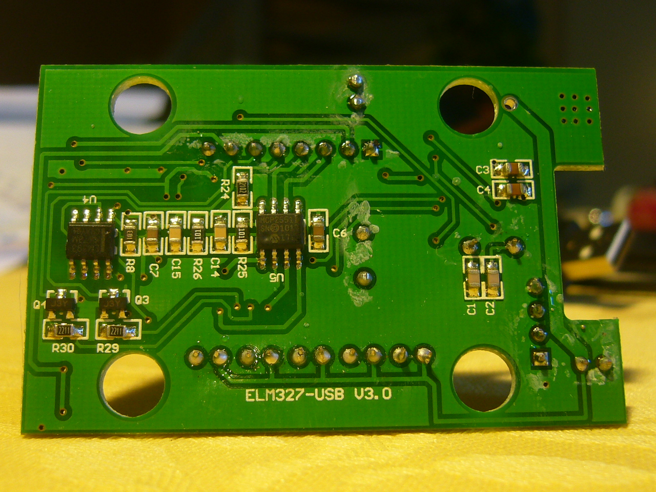

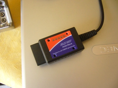

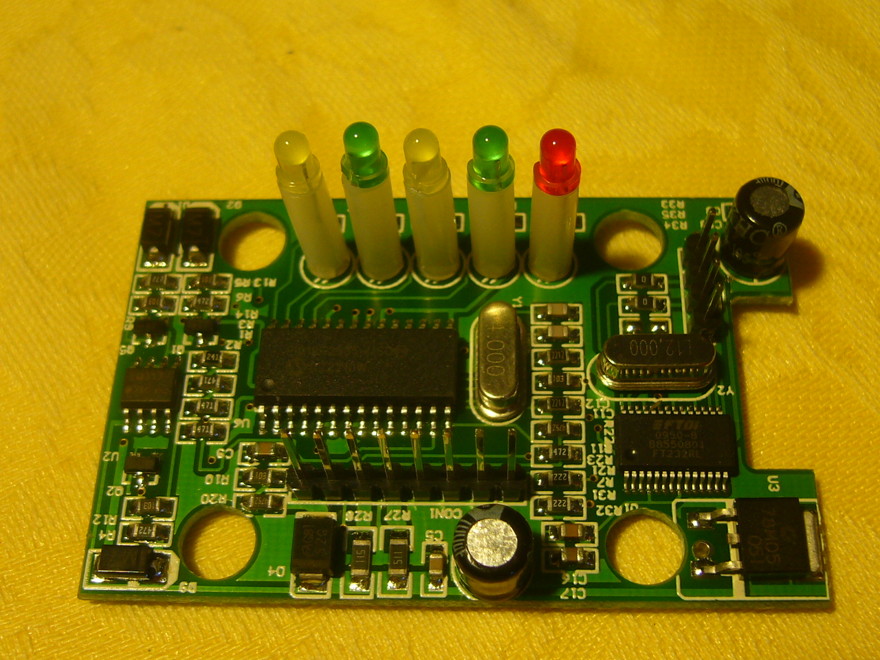

Another cheap 'Chinese clone', from eBay (UK seller, not china or HK), received 3 days ago.
It was sold as ELM 327 1.4 'with a genuine ELM chip'. :?
(For my personal information, I would really like to recognize a genuine ELM chip from a fake one)
Actually everything is working well FES wise, which makes me think it is actually an genuine ELM1.4
- NO communication problems, all ECU are recognized.(Airbag and steering not tested, pins 1-7-9 not soldered yet)
- NO problem to get access to service reset.
- NO installation problem. Just the drivers for FTDI USB to install.
Although the box looks the same,
PCB is quite different (named  [b]'USB V3.0'[/b]) from the versions pictured on previous posts
(C14/C15)
(C14/C15)
On the last pic we can see the 100 Ohm resistors (R25/R26) for CAN H/L lines with associated capacitor (C14/C15)
Same combo shown by members in the last posts.
Hope it can help you to find the correct interface
Best regards
Sébastien
