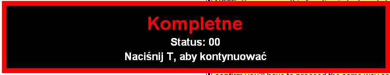

One more problem in polish language:
The program tells me to press T, but it does not work. If you press the Y is all is well.
BAS

Yes, you have to press Y.
The procedure for programming remote controls is as follows:
1. Start procedure and press Y to confirm that you have read all notes
2. Enter your security code and click OK
3. The program will notify you to prepare Remote Contol 1
4. Press Y and in less than 15 seconds press any button on remote control 1
5. The program will confirm that recognition is completed with result code 00, and you have to press Y to continue
4. Then the program will notify you to prepare Remote Contol 2
5. If you do not have remote control 2 just press N and it will continue to step 10 below
6. Press Y and in less than 15 seconds press any button on remote control 2
7. The program will confirm that recognition is completed with result code 00, and you have to press Y to continue
8. Then the program will notify you to prepare Remote Contol 3
9. If you do not have remote control 3 just press N and it will continue to step 10 below
10. The system will store the remote controls in memory and notify you that the process has completed with result code 00, and you have to press Y to continue.
That's it.
