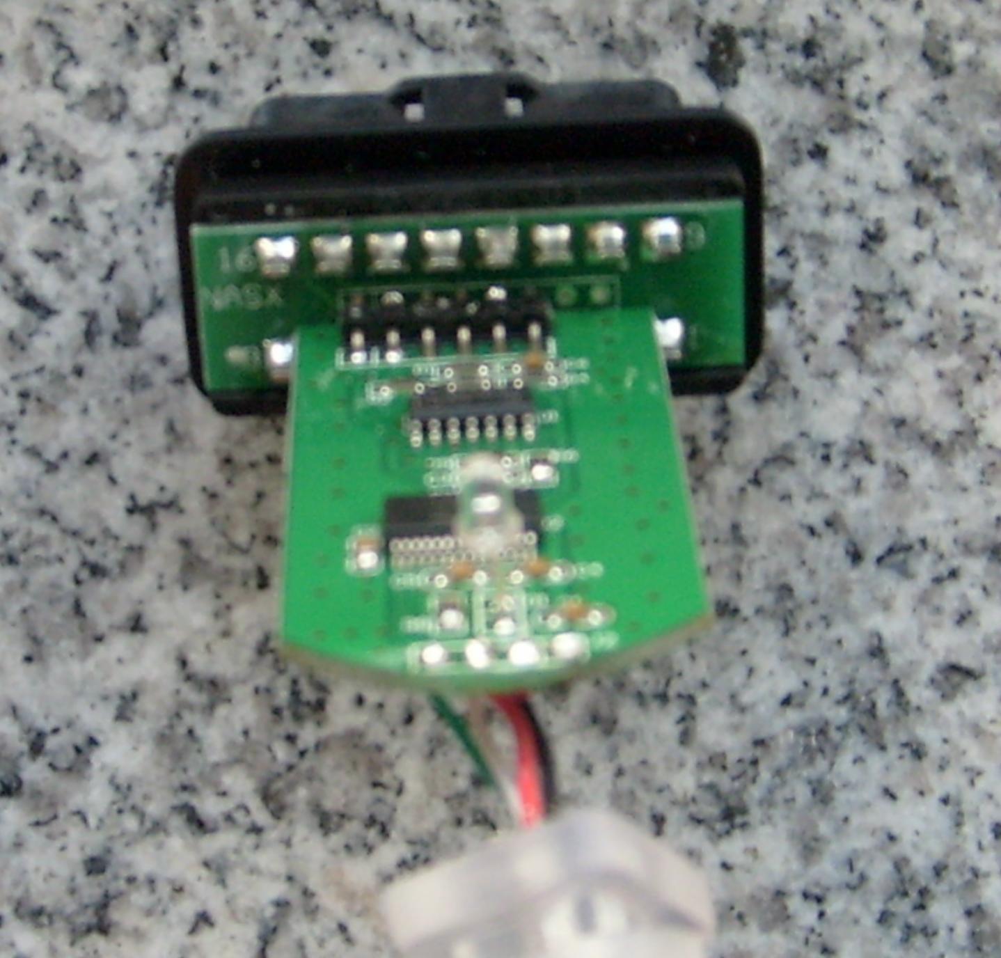

Hello everybody,
I want to modify an VAG Connector for use with Fiat ecu scan, ill readet all of the postings for this post but didnt find this connector, maybe someone can tell me wich pin in this connector i have to unsolder ( K-Line)

Hello!
I've got blue box, similar with that on foto in previous messages (1 LED, 2 chips, no marks on PCB board)
"USB OBD-II-2 KKL 409.1 OBD2 Cable VAG-COM for VW/AUDI"
chip is FTDI FT232RL
with FTDI serial port drivers on CD
When installing, I've new serial port, and usb serial converter, and sometimes a new unknown device.
When I try to check scanner, Multiecuscan returns timeout when trying ATZ command, and LED on OBD-II doesn't blink.
VAG KKL utility says "Port OK, interface not found"
LED is off.
Is it possible to check scanner on PC or my device itself cam have problems ?

Hi there Hgbutte , I have only witnessed the cable together with Several point of sales dil swap plus it looks very professional .
I purchase everything you do, but in your wire assemblage that we obtained through Craigs list which in turn appears to be the blue one among yours , however when the covers tend to be removed the bond to be able to flag 7 for the 16pin OBD plug will be hidden which has a small Some green single throughout collection connection onto the major table along with visits Three or more hooks around the main signal table.
It is good in the event you can display the internal electrical wiring of your respective package along with in which the K line connection to pin Seven OBD is really reduce.
