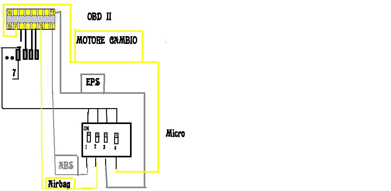

I would like to connect to ESP. My car is a Fiat Stilo 1.9 JTD build 2002.
First I tried to solder Pin 7 to 9, but I didn't get any ECU response.
Next I bought a DIL switch an did exactly as jernejL and oem posted (thanks to you for the images, I have the same type of cable).
Now i can connect to ABS and Airbag, but from ESP still no ECU response (Engine is not working as well).
I thought of a differnet pinout, but couldn't find anything usefull in the internet (just the known scheme).
Any help would be appreciated, thanks!

jernejL wrote:Hi!
Thank you guys for helping us out, especialy "davan", "pepazdepa 408" and "oem", which were for me the most helpful since its' the same type of cable.
I'd like your confirmation before I plug this one to my car, I'd realy hate it if everything including airbags went to hell...
If I'm not mistaking, it should work like this:
switch 1 to ON position - engine
switch 2 to ON position - airbag
switch 3 to ON position - ABS
switch 4 to ON position - EPS
(all other positions OFF)
Thank you all again!
cheers
Is that the example of the cable change VAG jernejl working properly?

Who can tell me if it works thanks
obd 2.jpg (46.72 KiB) Viewed 56686 times
