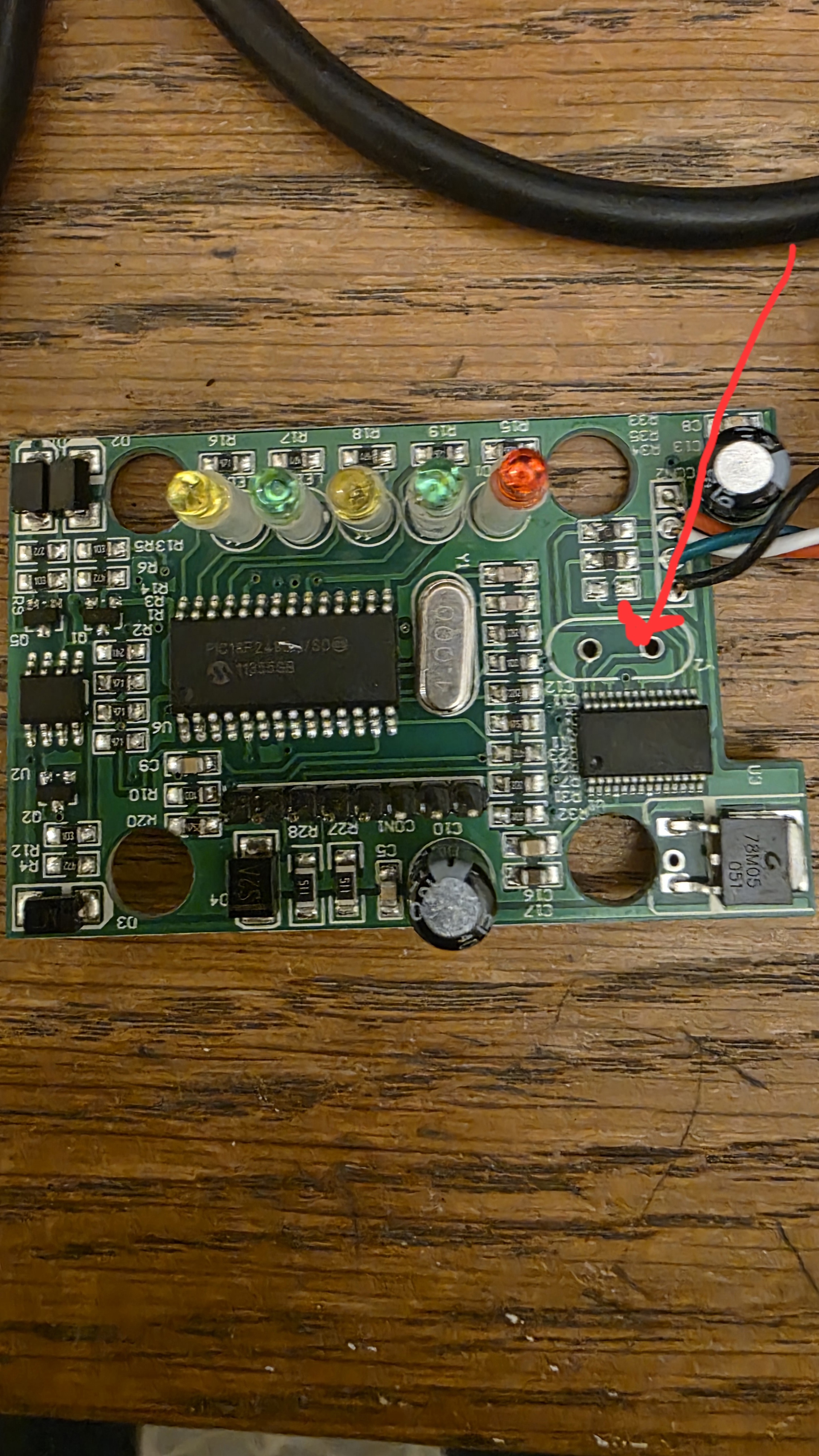

This is my ELM327 - one part is missing (I've marked it with an arrow). Could this be causing the connection problem?
