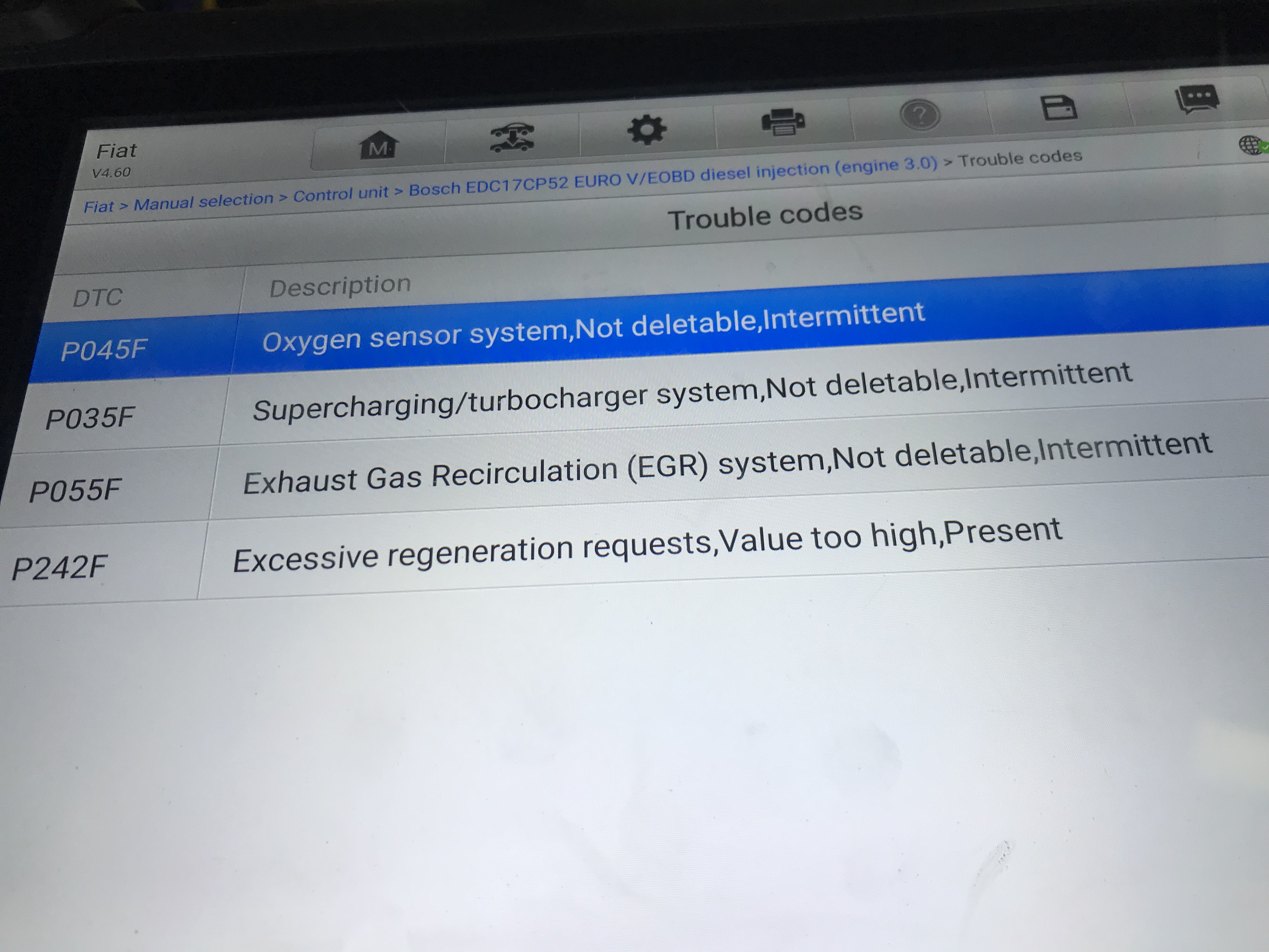

Hi all, can someone tell me if the Autel J2354 devie will work with this software if i purchase it , we use autel for many of our 80+ vehicles, but the autel device has some major isses speaking to fiat vans

thanks for the reply, have just ordered one that says 100% compatable elm 327 for multiecuscan, my issues are i cannot clear codes using a autoel maxi sys device, t
he error codes come up like this
awe have replaced the dpf but just cannot tell the ecy we have done so
