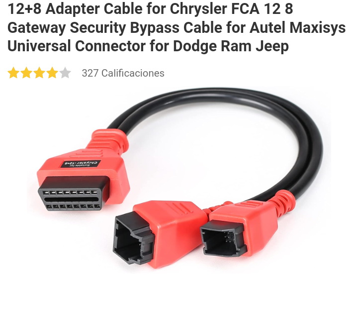

check if car has SGW.

I hadn't thought about that, surely that's the problem. I'm going to buy a sgw cable
