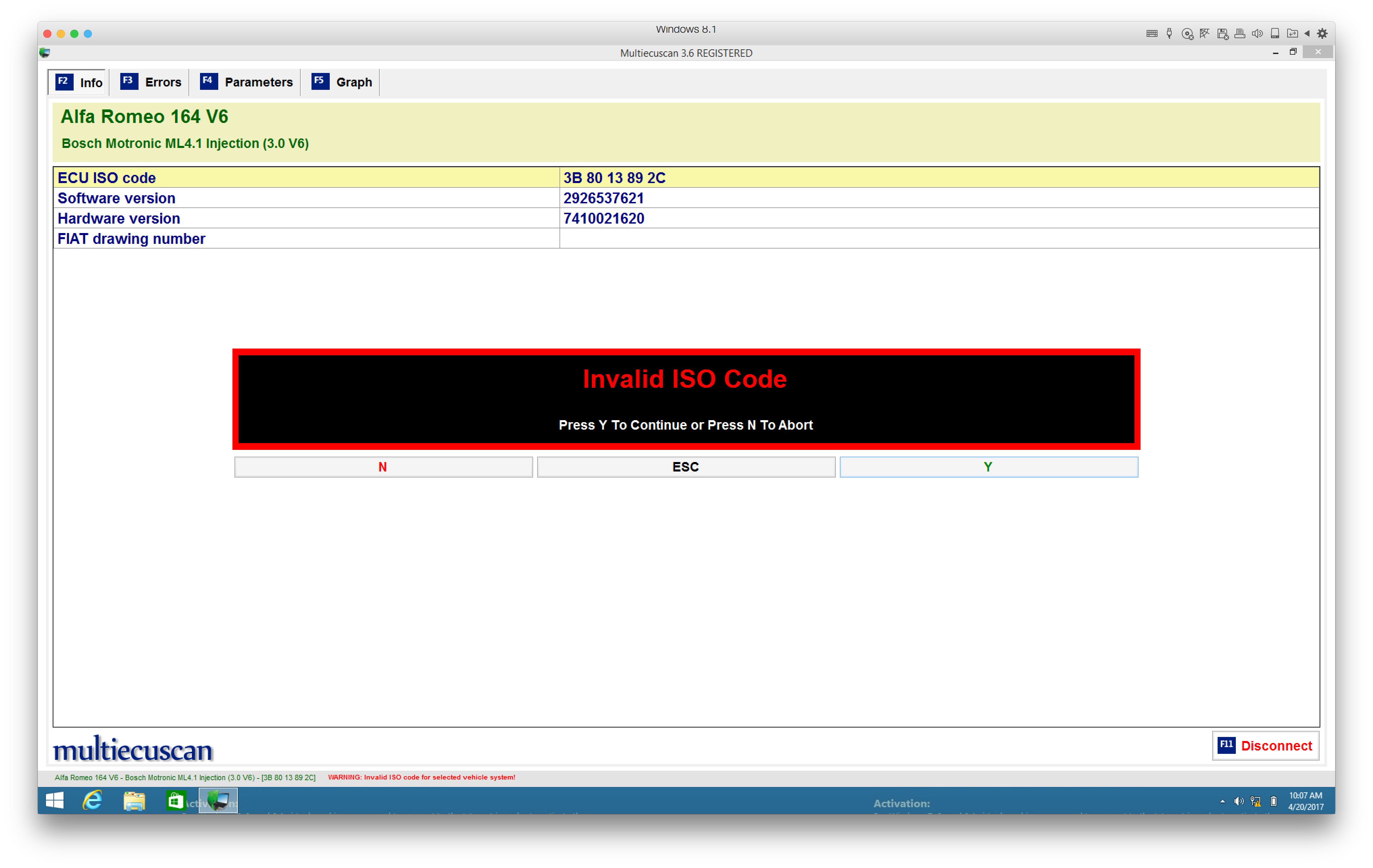

I know that several models of the Alfa 164 (ie: V6 & QV etc) share the same ECU as the Alfa 33 16V with ML4.1 Motronic and can actually be used to connect (with an "Invalid ISO code" warning) to the 33.
Screen Shot 2017-04-20 at 10.07.42 am.png (512.05 KiB) Viewed 3408 times

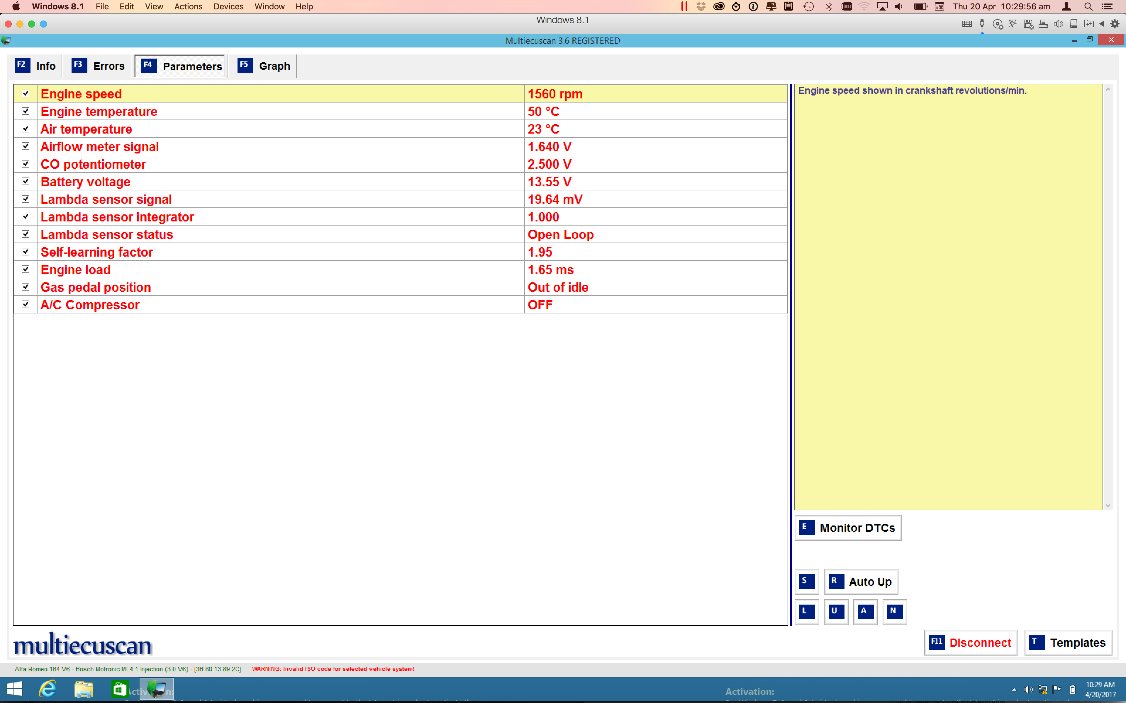

However while it is possible to connect, the connection seems to drop within a few seconds when the car isn't running... I get about 15 seconds when it is running which is just enough time for all the parameters to be displayed and maybe update once or twice, but then the connection drops.
Screen Shot 2017-04-20 at 10.29.56 am.png (454.72 KiB) Viewed 3408 times
