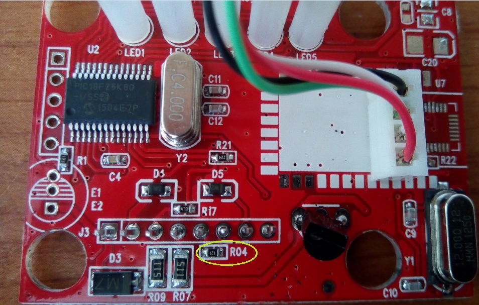

i have this elm v1.5a
from what i saw posts above with someone that has PCB like mine, is to remove R04 underneath white plastic...
i removed r04 but i still have conneciton problem (i can connect to ecu and the parameters...but after 30seconds connection disconect).
bit rate is 38400 on FES and com port settings.
i have all tests ok in interface tests on FES...
another IMPORTANT question that i haven't found the answer, with this "hardware changes" on ours Elm327 interfaces, will afect the normal procedure of the interface while using on other protocols (scanmaster for exemple)??
this is my pcb (i have this cable for about 3/4 years)
Sem Título.jpg (216.65 KiB) Viewed 18794 times

Hi Alfaeddy,
The driver is correct and interface works in ScanMaster with other car brand tested (with Seat)
The error like on the image i posted appears in multiecuscan, and none ScanMaster, and multiecuscan can't connect to my car Alfa Romeo.
I did removed resistor like you posted in the image but it's the same i still don't have connection to the car, and multiecuscan fails in test. So i guess this interface won't work at all.
Hello lonerunner
Your interface test shows that this ELM may not be compatible with Multiecuscan.
Unfortunately, it is often the case when the version v1.5 in ATZ and ATI is displayed the interface as not with MES functional.
Unfortunately, this statement is not universally valid
There are also v1.5 interface which work problem-free

I have also problem with conecting to CAN, but I cant find circuit layout similar to mine in previous posts. Which resistor should I remove?
LARGE IMAGE: http://shrani.si/f/m/SN/34vv2TBe/2/wp20 ... 010pro.jpg
Hello Replica
Because your picture is very bad
And little is visible.
I can only rate it
R2 ????
What number is on R2 ?????

Hello Eddy,
it is number 121. Should be this one?
Thank you
REPLICA wrote:Hello Eddy,
Thank you
Yes
