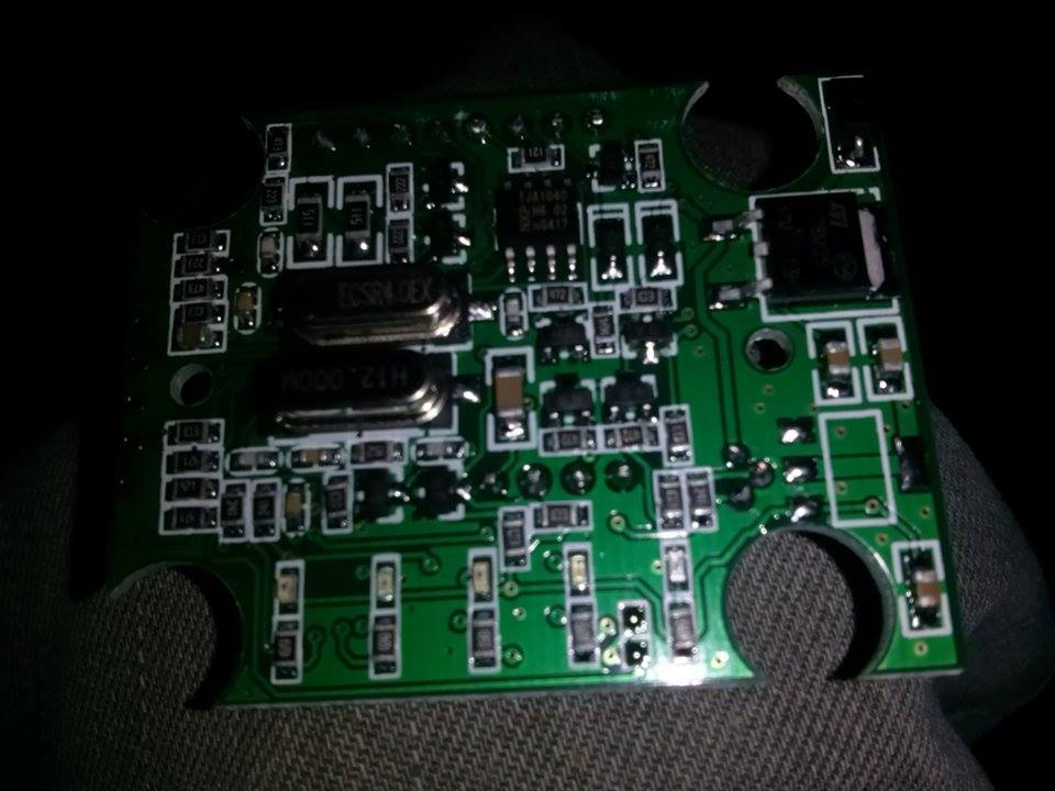

Hello, i have a 2009 alfa romeu mito and i can connect with engine, abs, etc (high speed can)
But i can't connect to low speed can
I think i most remove the bridge resistor
But i can't find where it is
Can any1 help me?
Here is my PCB
Thank you!
It is a ELM327 USB V1.5
Can any1 help me?
Here is my PCB
Thank you!

This interface we had been there several times
in red frame the bridges Resistor is highlighted

Hello guys,
I'm using a cheap chinese ELM 327 which doesn't work with MultiEcuScan even when it was original (with the resistor), this is the module:
As you can see i've already removed resistor R34 (120 Ohm) but i have the same error in MultiEcuScan.
With Torque, ScanMaster and PCMSCAn it's working fine.

As you can see in the test screen, this is a software on the chip
V2.1
And the v2.1 does not run with MES or AlfaOBD
Why this is so I can not say
This would require more Yani can say.
V2.1

In this case i will continue to use this module only with the software mentioned before (Torque, ScanMaster, PCMSCAN)
What version of elm 327 should I buy to make sure it's working correctly?
I have a Fiat Grande Punto 1.3 Mjet 66kW/90HP (2007) with a Marelli 6F3
P.s.: Do i need to re-solder R34 or I leave the module modified?
