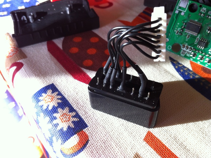

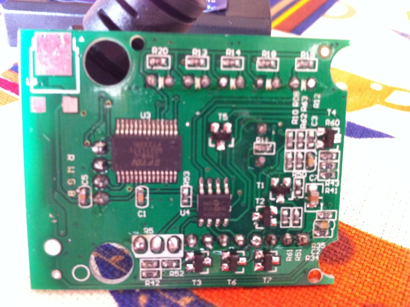

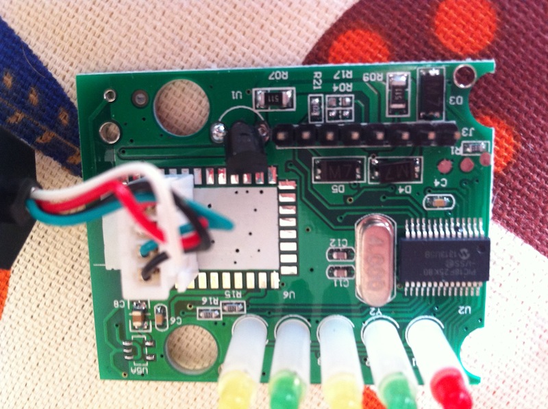

kokkoz
Joined: 01 Oct 2013, 14:34
Post by kokkoz »
i have buy this interface elm 327 v1.4 and don't
connet on the CAN of my Alfa Mito 1.6.
I try to remove r4 resistor but don't work.
Help me please :(

Tanis8472
Posts: 16
Joined: 22 Sep 2010, 21:02
Post by Tanis8472 »
I think you need registered version of Multiecuscan for all modules and only 3 modules are accessible via elm327 without adapter cables.
The resistor you need to remove is R04 which is the one nearest to the connector .
Engine should connect regardless of RO4 though.
Are you sure you have installed the correct FTDI drivers.
