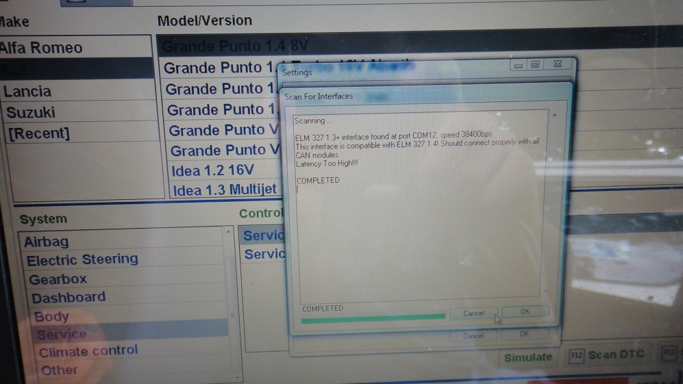

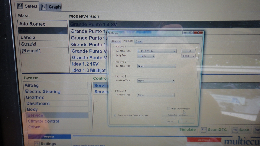

Hi all, I have an ELM327 V1.3a on USBV3.0 board and when running the test it passes all and says that I should connect properly to any can module, but when I scan the network I find only the BOSH Motronics ME7.9.10, BOSH ABS 8 ESP and the Delphi electric steering.
When trying to connect to the dashboard, it does not work and prompts the ELM327->ECU connection failed.
I made the modification of the switch to have both standard and type 3 cable with pins 6-14 switched on pins 1-9.
Following the pictures of my board that in the first pages appears the same marked as good one.
I am trying to connect to an Alfa Mito 1.4 Turbo 16V
Any hint to solve this issue?
