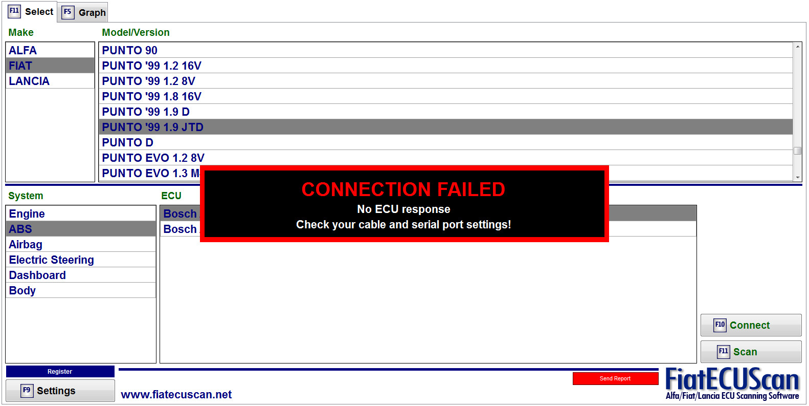

I have bought a vagkkl cable but cannot connect to the ecu scan. 'Ve had quite a few forums gone off, but nowhere to find an answer. Therefore this post.
I have done the necessary settings (see screenshots). But everytime I get the message "no eco response" who CAN HELP ME
no eco respons fiat punto 2001 19jtd
- 3.jpg (107.05 KiB) Viewed 4488 times
- 2.jpg (48.9 KiB) Viewed 4488 times
Re: no eco respons fiat punto 2001 19jtd
In your first screen you clicked your ABS and not your ECU
For your ABS you need a switchable KKL or an adapter plug green
For the ECU are no adapter needed
Have you in Multiecuscan / settings indicated a KKL and the correct COM port?

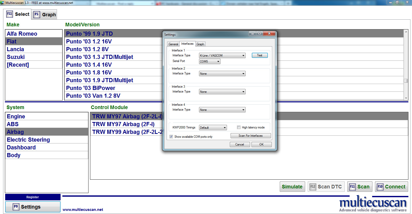

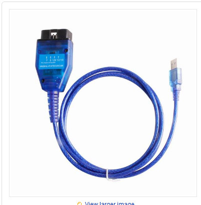

Hello, thank you for you answer.I have purchased this cable and there are 4 things that I can read, airbag, engine, etc. the cable is on position 1 during the screenshots. Greetings
- 2.jpg (125.13 KiB) Viewed 4483 times
- 1.jpg (29.62 KiB) Viewed 4483 times
Ah, OK
With the switchable KKL you need no adapter cable, properly
Charging you this driver for your interface
And check the settings in Multiecuscan as I wrote
then it should work
Ah, OK
then it should work

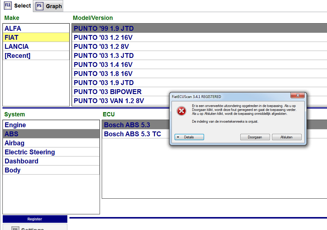

I have checked everything again, and now this is the error message (see screenshot) also have another version . put out a test done on the cable (which is also good) .... But still no connection
- a.jpg (175.71 KiB) Viewed 4463 times
You still used Fiatecuscan 3.4.1??
this version is very old!
And if I remember correctly this version had severe problems with the KKL connection
Charging you the new version of Multecuscan and try it again
Und die Sprache in dem Fenster kann ich nicht übersetzen
Or is not this version correctly

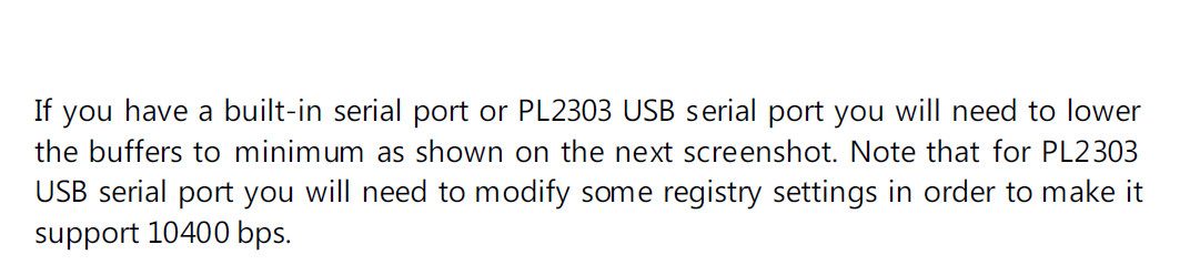

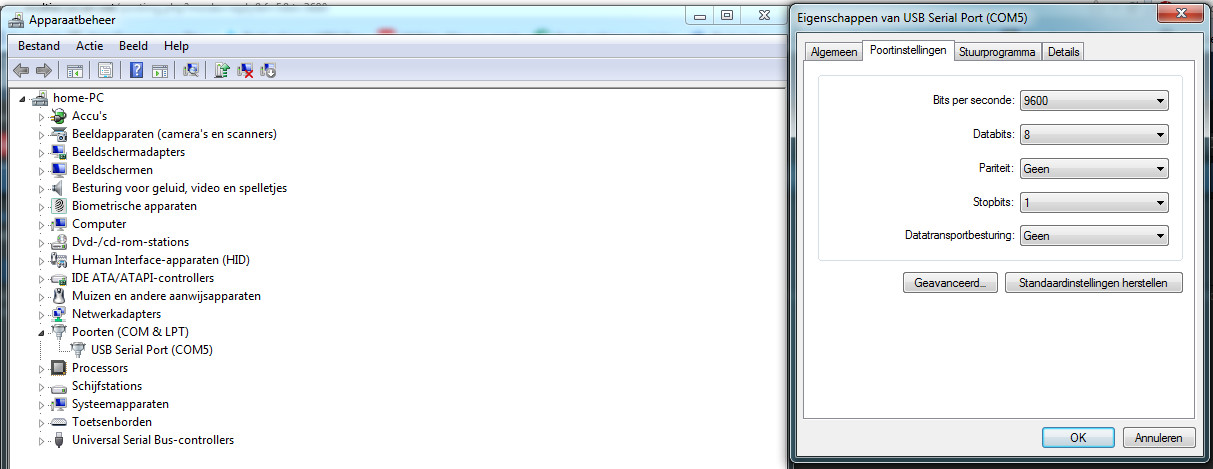

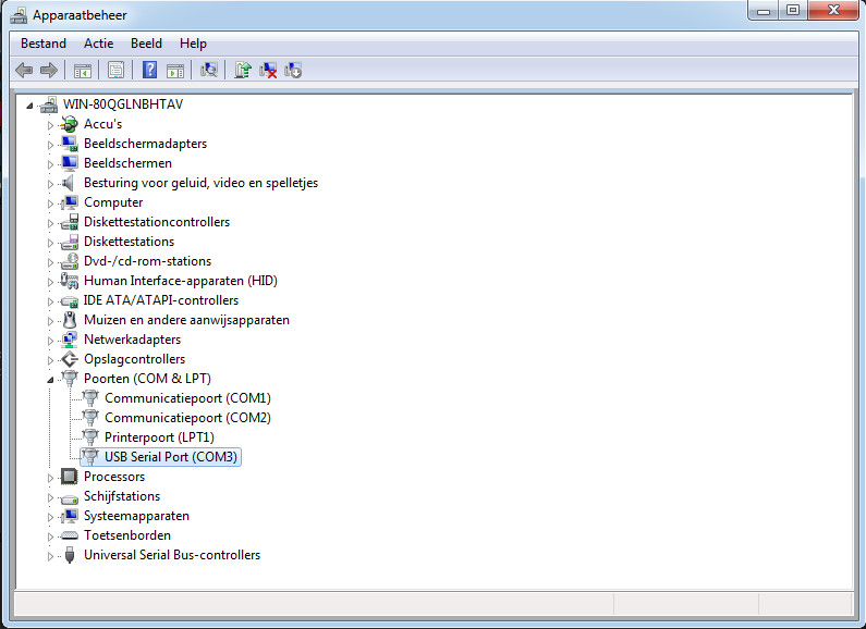

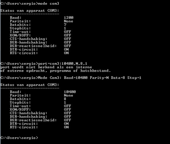

I have the latest version picked up at this site. But still he gives that I get no connection. Have also read the manual but there is something in of 10400 bps. That I only get in dos. But not in the com port settings of device manager. greets and thx
- d.jpg (272.36 KiB) Viewed 4458 times
- c.jpg (128.81 KiB) Viewed 4458 times
- b.jpg (78.09 KiB) Viewed 4458 times
who can help me...... plaese
