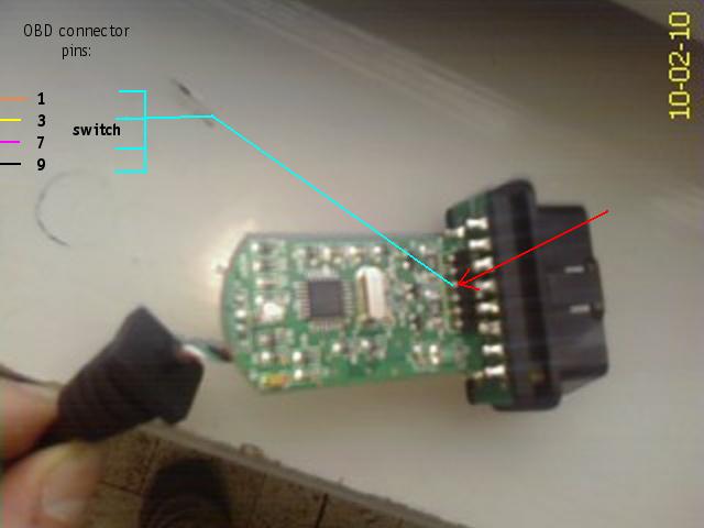

I have read all the posts, but still can’t understand how to get it to work for the airbag (i have plugged it in and got it working with the engine ECU in standard form). What is the Kline (“connect kline to pin 3”).
Do i have to physically cut anything or just solder in a wire between 2 pins. I like the idea of adding a dip switch to enable all functions, but is a bit beyond my skill level, so just for now i just want to reset the airbag light.

yes you have to cut the wire shown on photo by davanshelleyamy wrote:Do i have to physically cut anything or just solder in a wire between 2 pins. I like the idea of adding a dip switch to enable all functions, but is a bit beyond my skill level, so just for now i just want to reset the airbag light.
cut this wire! when you cut this wire you will get left side of cut wire and right side of cut wire. Connect pin 3 with left side of cut wire and than you can connect to AIRBAG ECU!
p.s. davan sorry for copying your photo!

if it is too much, you can connect pin 1 + 3 + 7 and than you can start multiecuscan program and then you can connect to ECU (airbag + engine)!
but this is not recommended...
p.s. davan sorry for copying your photo![/quote]
Thanks Alfa
I took a chance and just solderd a wire between 3 and 7 and it worked fine. I was able to connect to the engine ECU and the airbag ecu.
I would still like to be able to insert a dip switch and have all the functions, including the VW capability.
Mike
